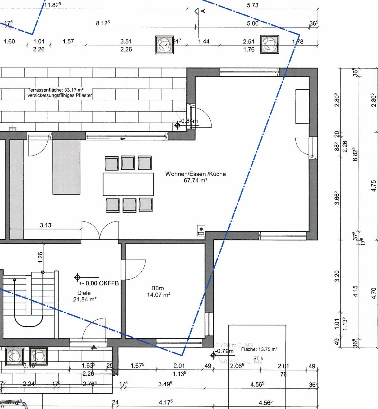

we are currently planning a new build project and are still struggling to find the ideal way to arrange the living room. Since we are still at a stage where window placements can potentially be changed, I am curious if you have any good ideas. I have attached the floor plan below. The focus is on the right section in the extension.
Basically, the following items should at least fit in:
The basic idea is to build a wall (possibly half-height) as a room divider from the fireplace towards the dining area. According to the current plan, the wall would be about 2.8m (9ft) long as seen from the living room and would end with a gas fireplace with 3 glass panels, each of the panels on the long side being 75cm (30 inches). The window above is intended to be a kind of panoramic seating window with a wooden bench instead of a standard window sill.

Our concern with option 1 is whether the inserted wall might be too short. On 2.8m (9ft) width, the fireplace with around 75cm (30 inches) of visible glass and the TV with about 167cm (66 inches) width would need to fit, which could feel a bit cramped. The advantage is that from the sofa you can clearly see the fireplace, TV, and garden. The armchair can face the fireplace, TV, piano, or garden, making it very flexible.

So it feels like all options have their pros and cons… since the window planning also depends on this, we need to make a decision soon. Are we perhaps missing the best option that we haven’t thought of yet? Do you have any good ideas or tips? Which option would you choose?

hampshire28 Jun 2021 17:44The layout follows your priorities. No one can set them for you. What is most important should be given special consideration, followed by less important aspects. It’s obviously best to incorporate these parameters (how you want to live) into the architectural design. The house serves the homeowners, not the other way around.
Example:
How important is enjoying music in this room? If it’s "very important," the type and placement of speakers will largely determine the setup. This was the case for me in the past: I set up the sound system first, and everything else had to adapt; some even called it my hi-fi altar...
If music is less important, the speakers can be placed in corners, directly against walls, or replaced altogether.
Not only "cramped," but also the thermal impact of the fireplace on the TV is worth considering.

With a width of 2.8m (9 feet 2 inches), the fireplace would have to accommodate a viewing window about 75cm (30 inches) wide and the TV about 167cm (66 inches) wide, which might feel somewhat "cramped."
