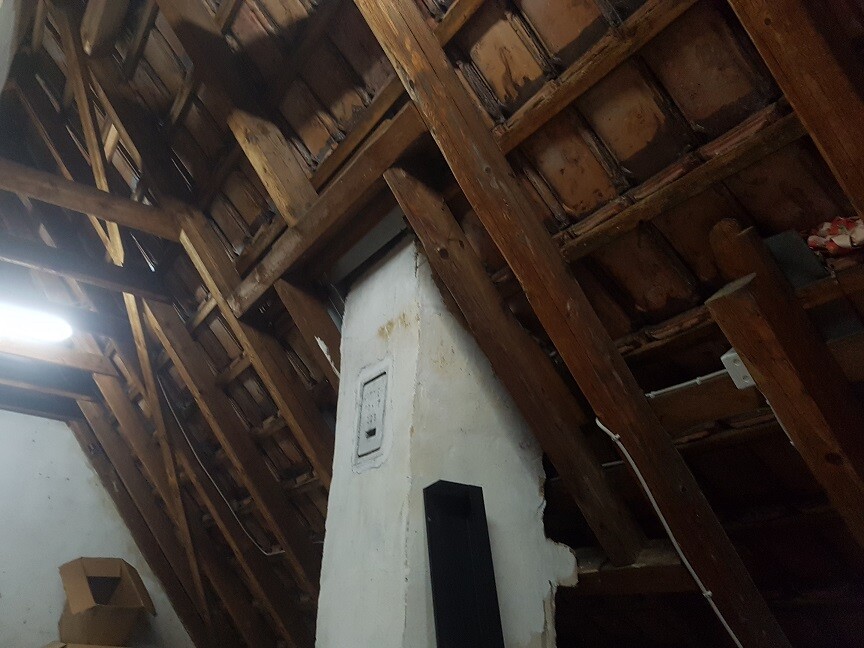

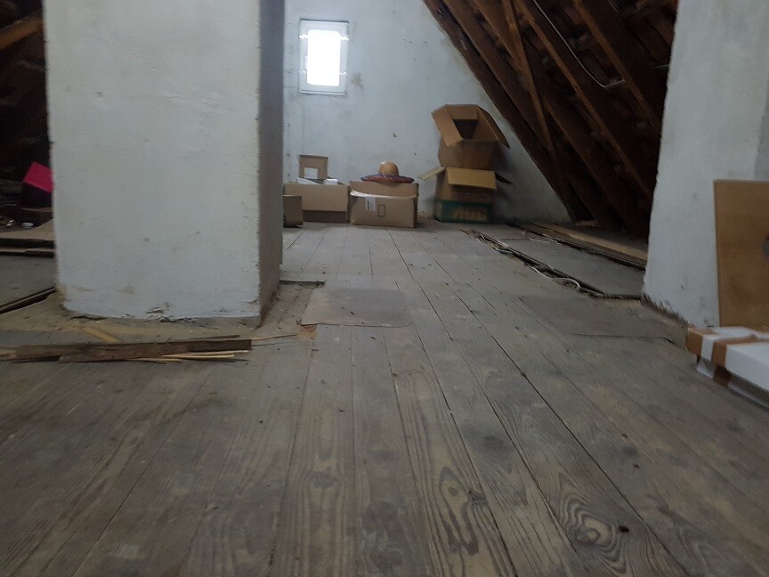

Brief info about my attic:

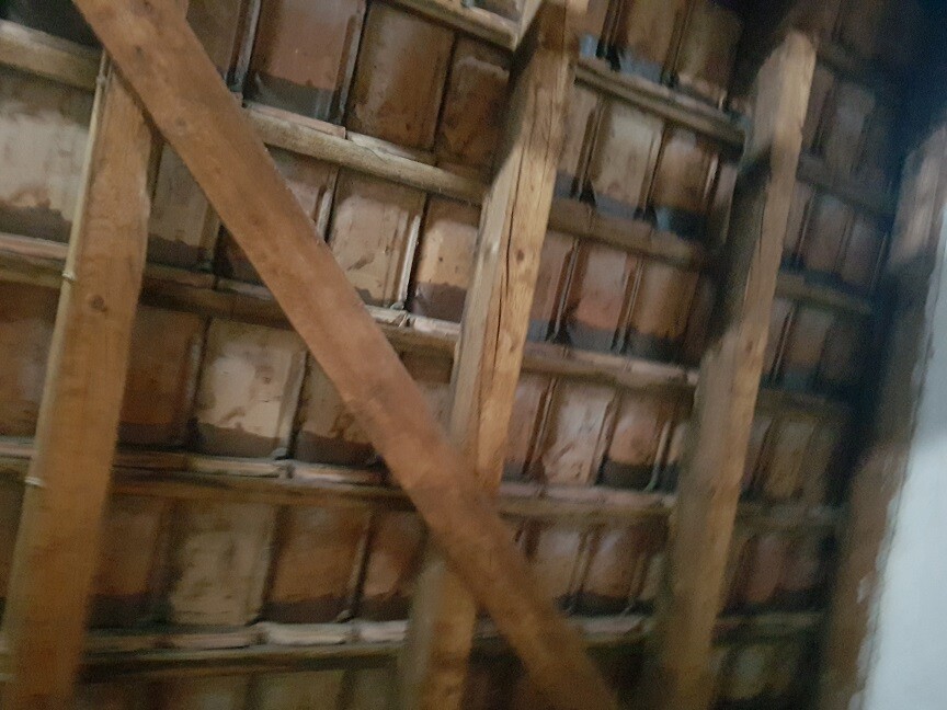

My house has a pitched roof attic, which is completely uninsulated and as it was from 1960. You can see the rafters, battens, and tiles (see pictures). The roof is watertight (everything stays dry during heavy rain), but unfortunately not windproof. Snowdrifts blow snow through the tiles from underneath, and in summer, dust and dirt also enter the attic. We want to fix this condition. The attic is only intended to be used for storage (Christmas decorations, Easter ornaments, boxes, and crates...).
The roof tiles are double-fired, glazed, and of good quality. They do not need to be replaced, so I want to avoid re-roofing.

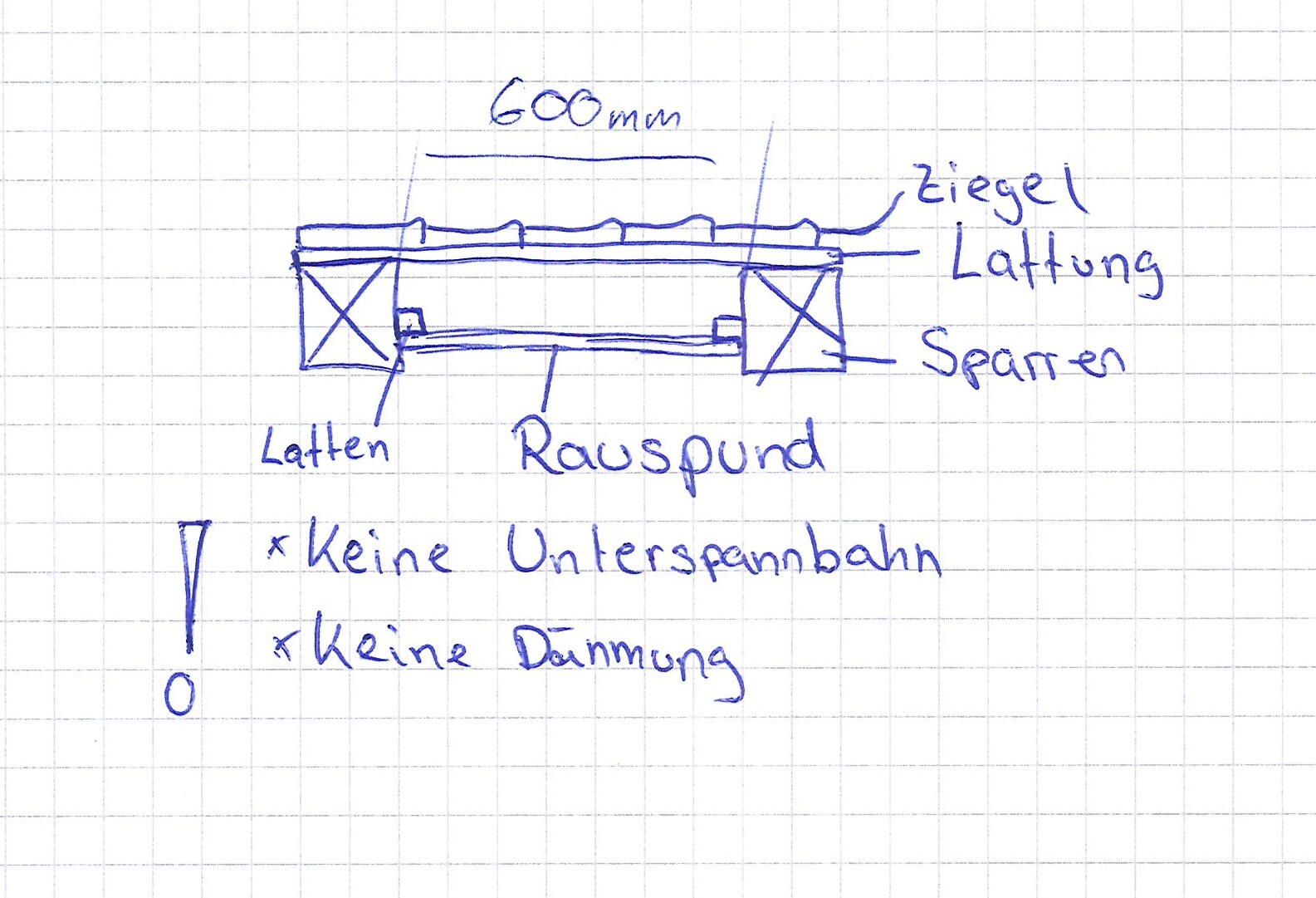

My plan:

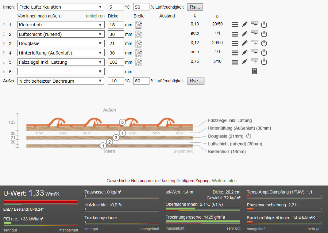

I have decided to install a small sub-roof between the rafters. Essentially, to lay 21mm (0.8 inches) thick rough-sawn Douglas fir tongue-and-groove boards between the rafters. This will only provide minimal insulation, but that is not my goal. Wind can still pass freely between the boards and tiles, so the entire roof remains breathable without me having to worry about moisture and mold. I want to avoid installing an underlay membrane and vapor barrier as much as possible. I don't want to insulate, only cleanly cover it so that snow no longer blows in, and no dust or dirt can enter.
If strong wind pushes snow under the tiles, or if there is a chance rain could be blown up under the tiles and leak inside the attic, it should be fine because the attic is sufficiently ventilated and can dry out.
Should I be concerned about anything else?
Do you have any other ideas that could be implemented for a modest budget? I can spend up to 5,000€ (around) for the attic work. Anything beyond that is not worth it for me.

Just cover it properly so that no more snow blows in and no dust or dirt gets inside. If it then extends up to the tongue and groove paneling (which I would also leave unsealed / vapor-permeable). Does this phenomenon affect both sides of the roof equally? (In the pictures, it looks like a roof with an asymmetrical pitch.)
That was a quick response.
No, the roof is symmetrical. It’s probably due to the angle of the photo.
I only noticed this phenomenon when there were really strong snow drifts, essentially when snow was blowing from ground level upwards.
It sounds strange at first, but that’s how it is.
I would also leave the tongue-and-groove boards natural and untreated.
Do you see any concerns with this? Or are there smarter, cost-effective alternatives?
