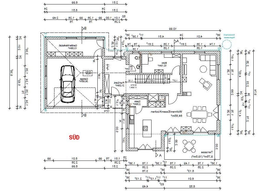

The floor plan is basically fixed, but for noise (street) and privacy reasons, we want to mirror the whole house so the garage, front door, bay window, house, and terrace are positioned from west to east.
Unfortunately, this has sparked many discussions because the plot was gifted to us by family whose house behind is slightly elevated (about 3m (10 ft), on the north side). They fear their house will no longer be visible from the south if we move the garage to within 2–3m (6.5–10 ft) of the western boundary. However, if we move it back 6–7m (20–23 ft) to where the current house corner is, there is about 80m² (860 sq ft) of "wasted space" between the boundary, street, driveway, and garage. Do you have any ideas on how to make use of this space or avoid it altogether without compromising the rest of the design?
The images still show the old version, as we will only redesign once we find a solution...

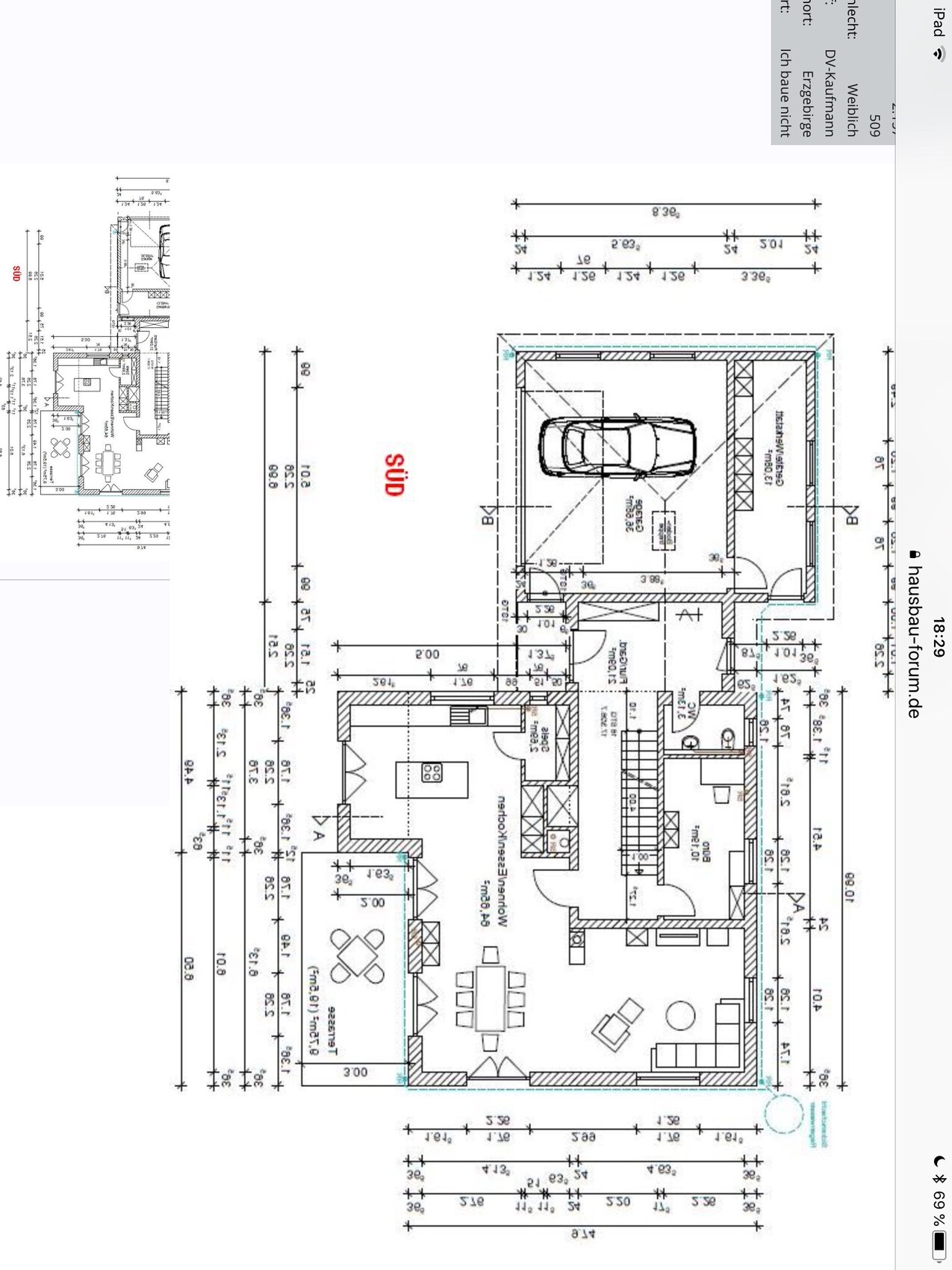

21 Aug 2018 18:07
Yes, I can’t mirror with my phone: garage on the upper floor, driveway from the west, terrace southwest

So, mirrored here, status from post 1 of https://www.hausbau-forum.de/threads/grundrissplanung-Stadtvilla-180m-mit-Keller.26308/
Ground floor:
Floor plan of a house with garage, open kitchen, dining area, living room, and staircase.

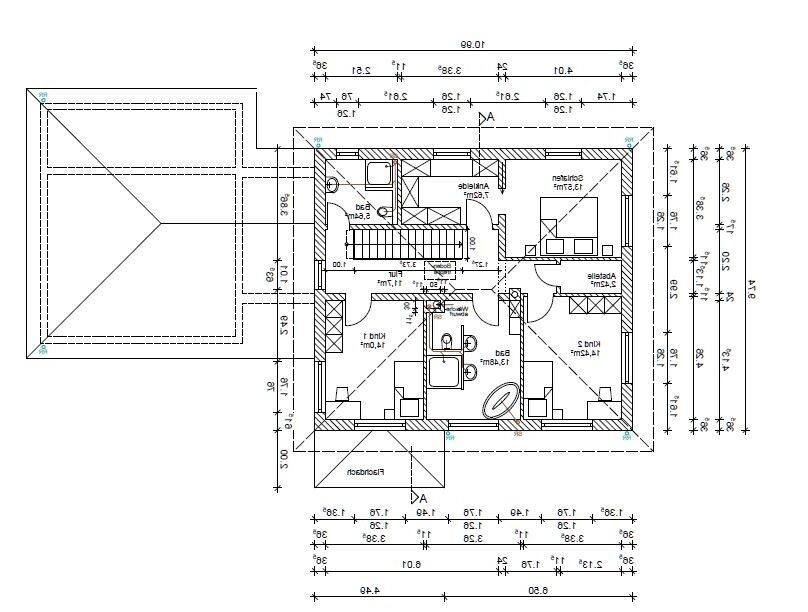

Upper floor:
Detailed floor plan of a house: interior rooms, stairwell, doors, and dimensions.

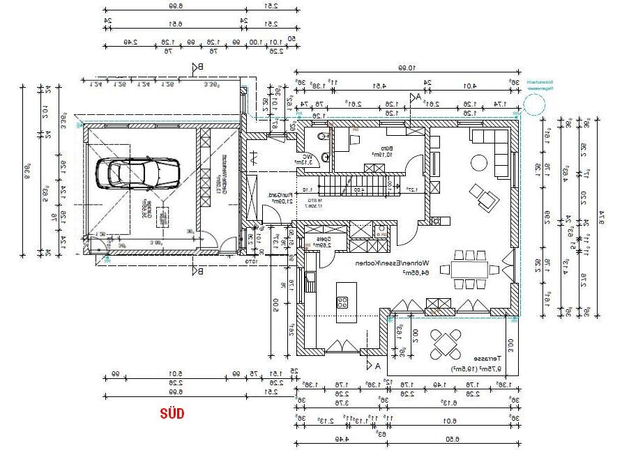

Ground floor: garage facing WEST .. storage room then as intermediate space
Floor plan of a house: garage with car, open living/dining area, kitchen, staircase, south.

A garage opening facing west would also allow for a west-facing terrace to be designed in the entrance area.
Oh, and to add to the question about the pantry window, why have a pantry when you also have a basement?
