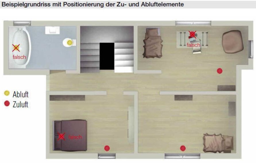

As I just noticed in a brochure from Maico, there seem to be two approaches to installing a central mechanical ventilation system with heat recovery:
1) The one I have known so far involves routing the exhaust and supply air ducts so that their vents are installed in the middle of the room and as far away from the door as possible, either on the ceiling, floor, or wall, as shown here (planning by Selfio)
Example floor plan: supply and exhaust air positions; yellow = exhaust air, red = supply air; incorrectly marked.

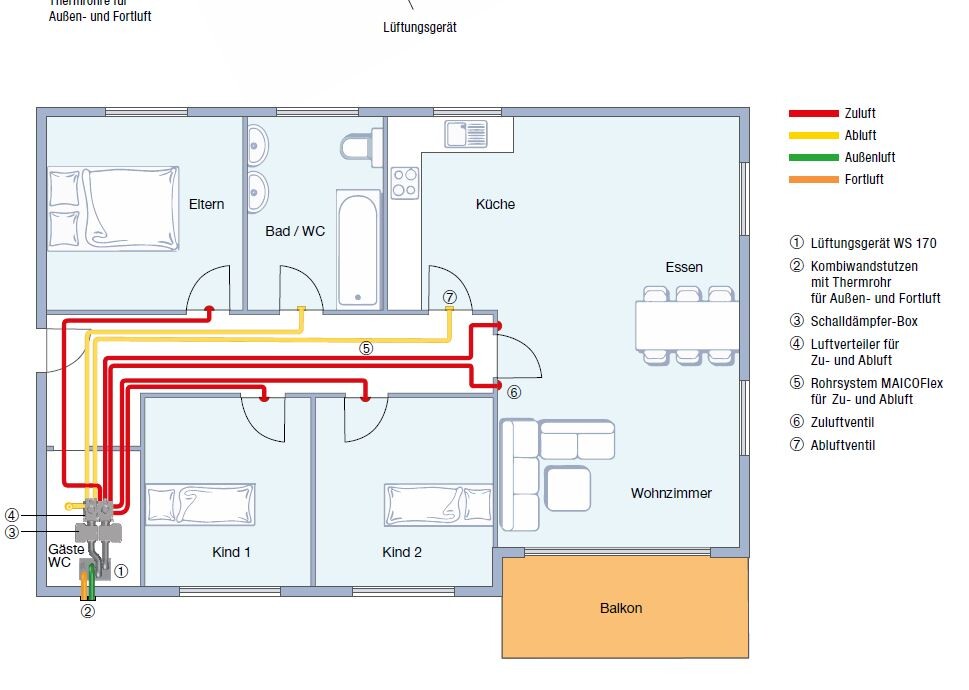

2) Routing the exhaust and supply air ducts only up to the doors, so that the duct runs in the hallway are as short as possible, as shown here (brochure from Maico)
Floor plan of an apartment with colored ventilation ducts, kitchen, bathroom, living room, and balcony.
My question is, who can assess which system is better? In planning discussions here on the internet, you mostly only hear about option 1. Is option 2 becoming more common now? Is it even possible to ensure sufficient air movement so that the mechanical ventilation system can work properly? Do any of you perhaps have option 2 and are satisfied with it?
Please let me know your thoughts.

Snowy36
15 Jun 2020 16:53
I can't understand how in option 2 any air exchange is supposed to take place in the room at the very back?!
Mycraft15 Jun 2020 16:59
Option 2 is the budget-friendly version. As a result, you get only limited mixing. However, you save about 1.5 meters (5 feet) of piping. Everyone has to decide for themselves what their priority is.
MayrCh
15 Jun 2020 17:20
Maico might be using long-throw nozzles in the supply air there. It wouldn’t be my choice.

Supposedly, air circulation in rooms less than 6 meters (20 feet) deep is not an issue.
But no one has actually had any experience with this, right?
micric3
9 Jul 2020 07:42
In our ventilation planning by Vaillant, the supply and exhaust air setup is similar to your Variant 1. I honestly cannot imagine how Variant 2 could work.
Edit1: You should have a ventilation concept created according to DIN 1946 for Variant 2 (or both).
