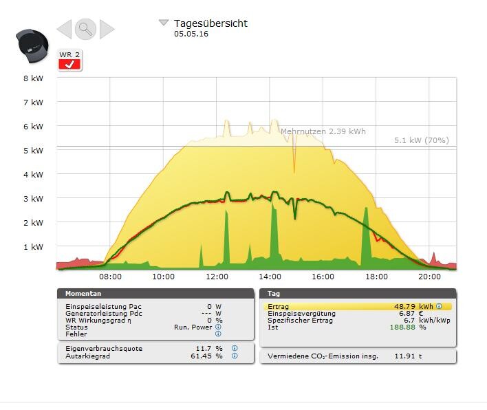

Our best photovoltaic day last year was in July, with 50.15 kWh. This year, it was in early May (May 5th) with 48.79 kWh. We have a purely south-facing system, and on those days the sun was shining fully, which means it must have gotten quite warm—especially the July day was certainly very warm. However, the heat didn’t seem to have much effect. Much more significant was the low consumption around that time on the May day when the peak yield occurred. So the system had to be throttled; otherwise, it would certainly have produced more than 48.79 kWh. You can clearly see in the picture how the consumption peaks (green) generate yield peaks... In our case, the system is not throttled when there is matching consumption, so we can use not just 70% but the full 100% of the yield.
Solar energy daily overview: yield diagram with curves and bars

Thank you, you have convinced me that an on-roof system is probably better,
- better ventilation
- no sealing issues
- more flexibility when replacing the modules
