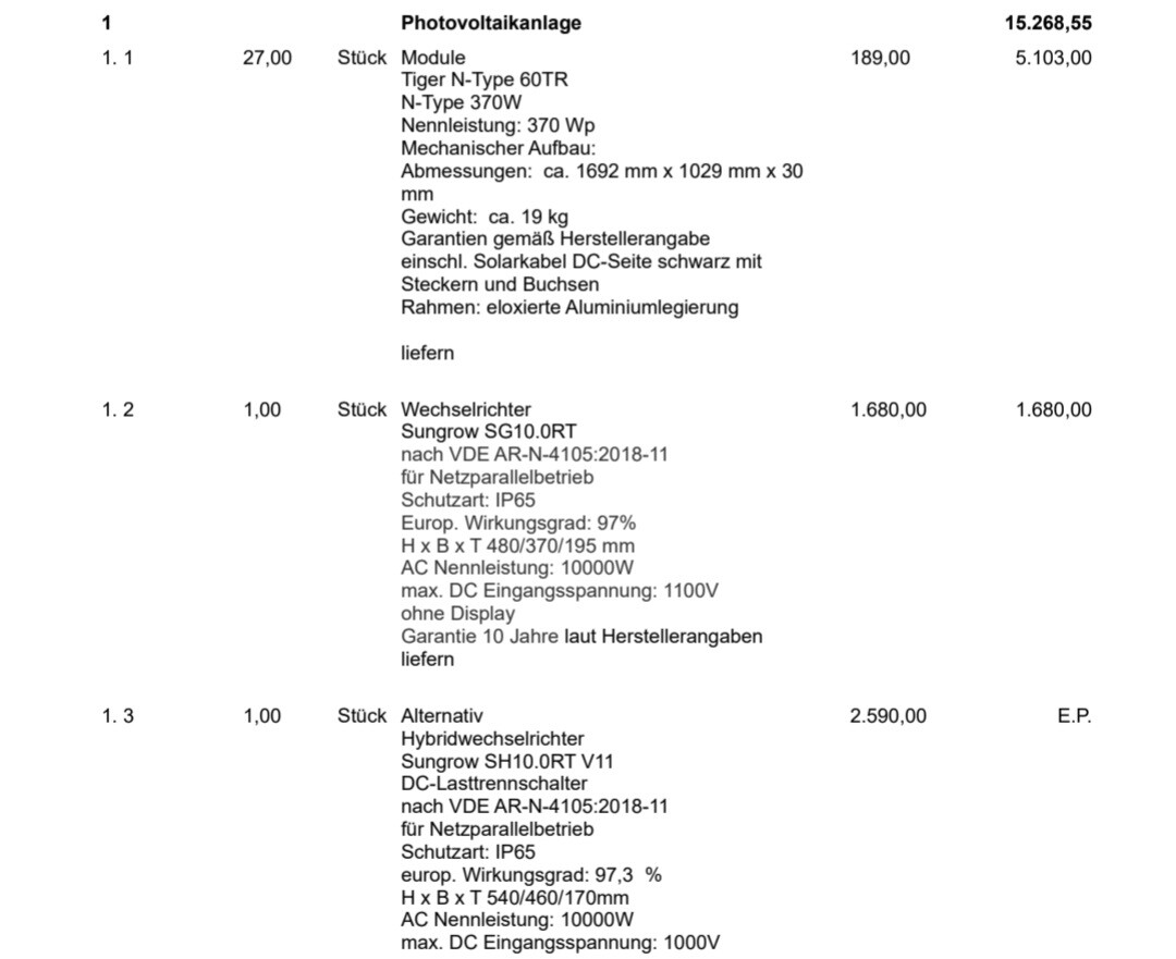

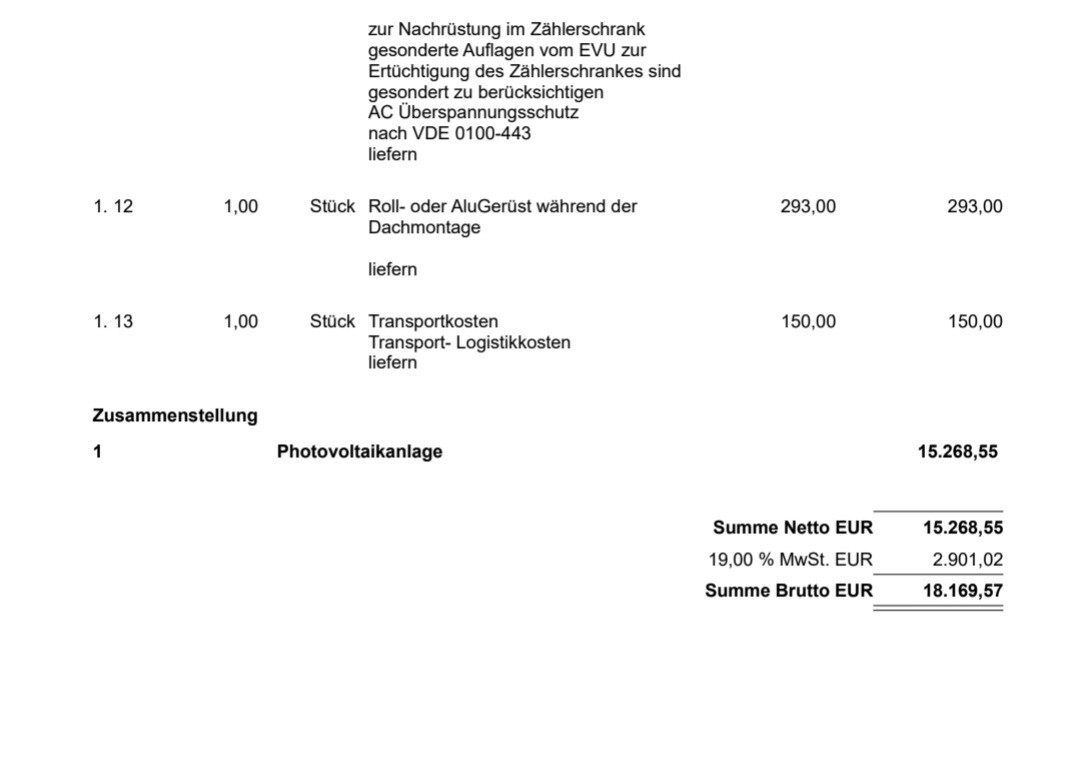

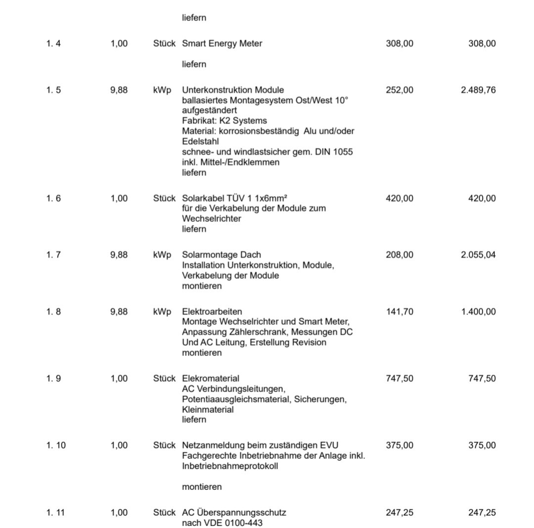

I am buying a green car for €20,000. Is that okay? 🙂 There should definitely be more information. Which modules, including the mounting structure, full black design, power optimizer? Here is the complete offer:
Mounting structure: yes, full black: no idea, power optimizer: no idea
I consider the offer of 1500 euros/kWp to be really fair.
At most, 1.9 from "Kleinkrusch Elektro" stands out as an exception. Otherwise, thumbs up.
And choose the alternative offer for the inverter, where you can add a battery later on and genuine backup power is also included.

Why exactly 27 modules? 9.9 kWp sounds like someone is trying to stay deliberately below 10 kWp without fully understanding the current system limits. The roof can actually fit a total of 14.4 kWp. That would be 36 modules. However, this would require a hybrid inverter and a standard inverter. The cost would be €21,800 excluding VAT.
To be honest, I’m still hesitant about all the tax-related issues.
gmt94 schrieb:
To be honest, I’m still hesitant about all this tax stuff.So you want to buy gross? Because VAT is definitely more complicated than filing the income surplus statement once a year.Fuchur schrieb:
So you want to buy gross price? Because VAT is definitely more work than filling out the simplified profit and loss statement once a year.I’m not even sure what I want yet. :-) I would need someone who can sit down with me and explain everything, showing me what to fill in where and how.
