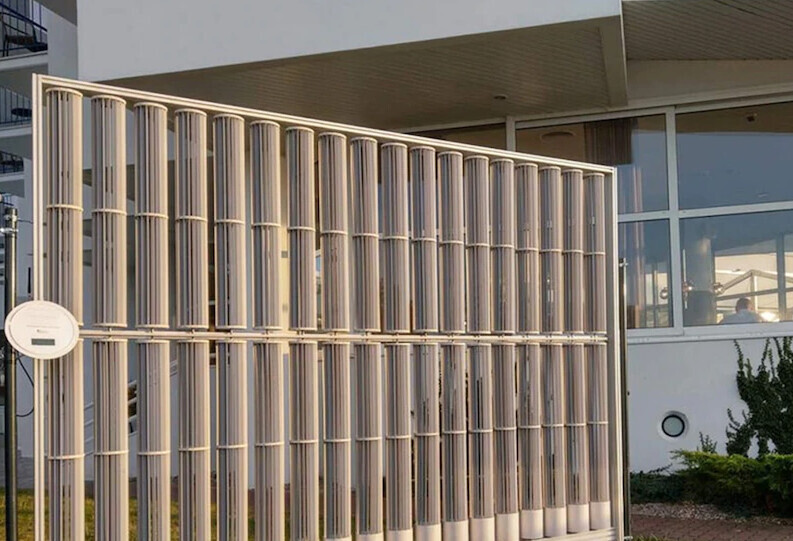

regarding those fence things:
Right now, there is a bit of a hype around them, with some developers trying to secure funding and investments. They don’t offer any real practical benefits. It’s completely out of the question to use any rotating elements as fencing. How would you secure that? What if a child puts their hand in there? What if animals try to squeeze through? How do you prevent reflections that could blind drivers?
As a proof of concept and a test to see if something like this works, it’s all interesting and exciting. But I don’t see any real chance for actual implementation. At best, maybe in a fenced-off area, but then wouldn’t it make more sense to install a conventional system there instead?

Andreas Then take a look at Panel Wiatrowy. That already goes in the direction of solving the problems you mentioned. If necessary, a thin kind of wire mesh fence can be added around it. That makes it suitable as a regular fence, for single-family homes or even industrial sites.

Do you mean this?
In a secured area, sure, it could be a cool idea. But as a fence? Never! Even attempting to get approval for that is hopeless. In Europe, something like this would be classified as machinery, subject to machinery directives and requiring CE marking. It just isn’t allowed.
Aside from that, the efficiency of a wind turbine at 0–2 m (0–6.5 ft) height is going to be very poor. There’s a reason why modern wind turbines have hub heights of 100–150 m (330–490 ft).

motorradsilke27 Nov 2022 20:28WilderSueden schrieb:
Not everyone has fence surfaces, and especially not good fence surfaces. This is where point 3 on my list becomes even more relevant. A 10–15 m (33–49 ft) mast next to 6–8 m (20–26 ft) houses is already challenging in terms of wind. A fence system usually reaches heights of 0–2 m (0–6.5 ft), so it remains much more sheltered from the wind. Possibly there is a hedge behind the fence, but even the neighbor's hedge across the street is usually enough. These effects are particularly strong at low to moderate wind speeds.
Many plots have fence surfaces. Where there isn’t one yet, you can always install one. Of course, not a hedge in front of it. Also, you can’t always assume your hilly region as the standard. There are plenty of flat areas in Germany as well, where it can be quite windy. In the city, naturally less wind, but in flat regions like Mecklenburg or Brandenburg, this could work quite well in my opinion.
Of course, not every technology fits every area. And of course, these units won’t be as effective as a large wind turbine. But you can at least place these units in villages, where they don’t bother anyone. Unlike wind turbines.
