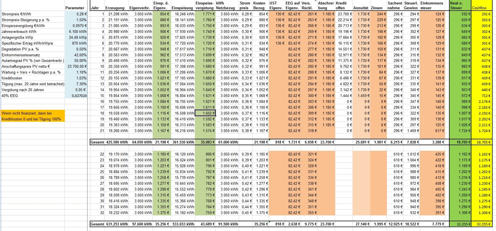

Attached is my calculation for the photovoltaic system. The scaffolding will be installed tomorrow. In 3 weeks, it will be on the roof, and it will officially start operating in January.
I would not recommend a battery storage system!
My system is calculated with a relatively high self-sufficiency rate of 50%. This applies to our situation; others might only achieve 30 to 35%. Nevertheless, the system would still generate a positive cash flow after taxes from the first year.

Specki Why? What appliances do you have that consume so much around midday that you want to achieve 50% self-sufficiency? There are also people who don’t manage that even with battery storage!
