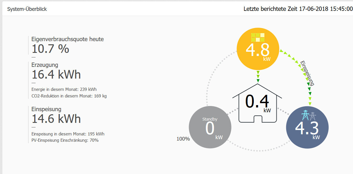

For example, I spent 17,000 euros for a 6.2 kWp system with a 6.3 kWh battery, and I’ve been thrilled with it for the past two weeks, seriously—but I will probably never see that money again. Hobbies always cost...
