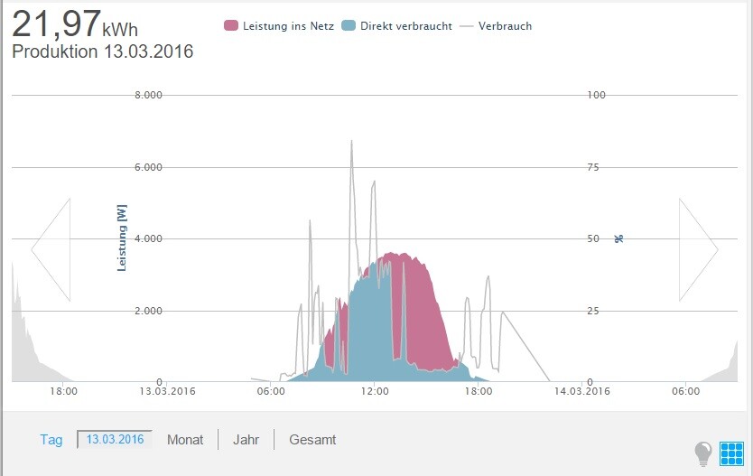

And this is what it looks like if you aim to optimize self-consumption around 9 a.m. Unfortunately, by around 2 p.m., the last power consumers like the washing machine, dryer, dishwasher, and vacuum cleaner had all stopped...
Check the individual consumption of your appliances.
As far as I remember (don’t hold me to it if I’m wrong), the dishwasher uses less power compared to the washing machine, while the dryer has the highest consumption. So, I would start the dishwasher between 9:00 and 10:00 a.m., then add the washing machine between 10:00 and 11:00 a.m., and begin the dryer from 12:00 noon (by then the dishwasher should be off and the washing machine possibly finished or about to finish so the dryer has something to dry). Vacuum cleaners or similar devices don’t run for long and can be fitted in between.
This whole theory becomes irrelevant if the sun decides to take a nap during the day.
toxicmolotof15 Mar 2016 12:48That was just an experiment over the weekend... I can’t use as much as is generated by the sun without clouds on an ongoing basis. The peak loads were caused by the heat pump anyway.
In that sense, what you have is what you have. Everything else has to be sold or bought.
