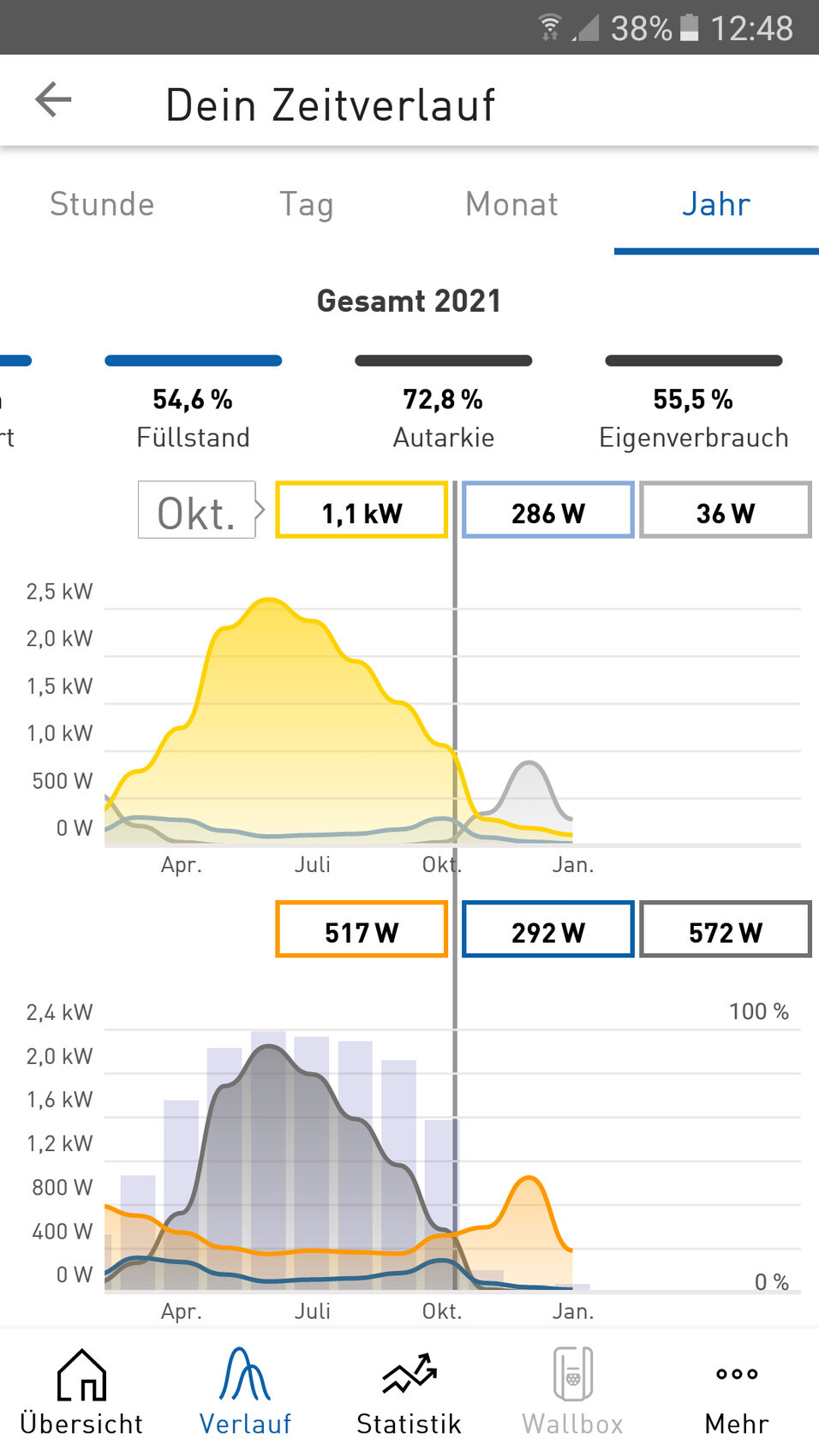

Self-consumption is what determines profitability nowadays. It doesn’t help to produce tens of thousands of kWh if you feed them into the grid at only 7-8 cents while paying much more for your own electricity. However, surplus is the key. Feeding that into the grid at 8-9 cents is not a bad option either. Of course, it doesn’t sound like much. And with a 5 kWp (kilowatt-peak) system, it’s not significant, which is why I plan to fully cover the roof and benefit from it as long as possible. That’s at least my plan.
But now, our hipped roof shape is complicating things for us.
Roughly speaking, for our region and including all costs, with 25% self-consumption, the system will pay off after 10-12 years.
