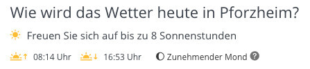

opalau13 Jan 2022 14:38
Weather forecast for Pforzheim with sun icons and times
No wonder you can reach 10 kWh even in January.
tomtom7913 Jan 2022 14:43
I was even outside in a T-shirt :-) but for me, it definitely helps to understand how much energy the sun produces.
Mahri2313 Jan 2022 14:47
We don’t expect more than 5 hours of sunshine again until January 18th. 🙄

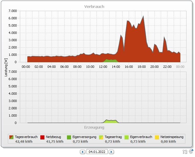

To illustrate the differences:
Probably the saddest day in the life of the system:
Consumption and generation chart: red consumption, green self-supply.
And no – nothing was broken.

OWLer13 Jan 2022 19:42
Since I don’t see any extreme peaks, the question is where is all the electricity going? I recently barely reached 80 kWh in a day during cold temperatures, but that was because I charged the car twice.
0.7 kWh is really very low compared to January 12th. What self-sufficiency rate have you achieved so far in January? With my 10 kWp east/west system, I have managed a decent 6%.
Deliverer
13 Jan 2022 20:39
My house has a heating load of about 9 kW at the current temperatures (~-4°C (25°F)). Most of the electricity consumption comes from heating. The power drops are all defrosting cycles, which also shows how humid the air is. Then there are two hours of electric car charging (3.6 kW), two laundry loads, one dryer cycle, and one dishwasher run. The base load is about 300 watts.
And yes – the fourth event was truly unlike anything we’ve seen before. It felt like night all day… November and December didn’t have a single day under 4 kWh. And then this happened…

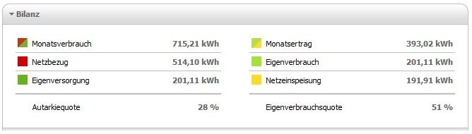

I’ve actually never looked into the self-sufficiency rate, but I found it for January:
Bilanz: Verbrauch 715,21 kWh; Ertrag 393,02 kWh; Eigenverbrauch 201,11 kWh
During the summer months, it’s over 70%; November and December are around 30%.
28 kWp system, no battery storage.
