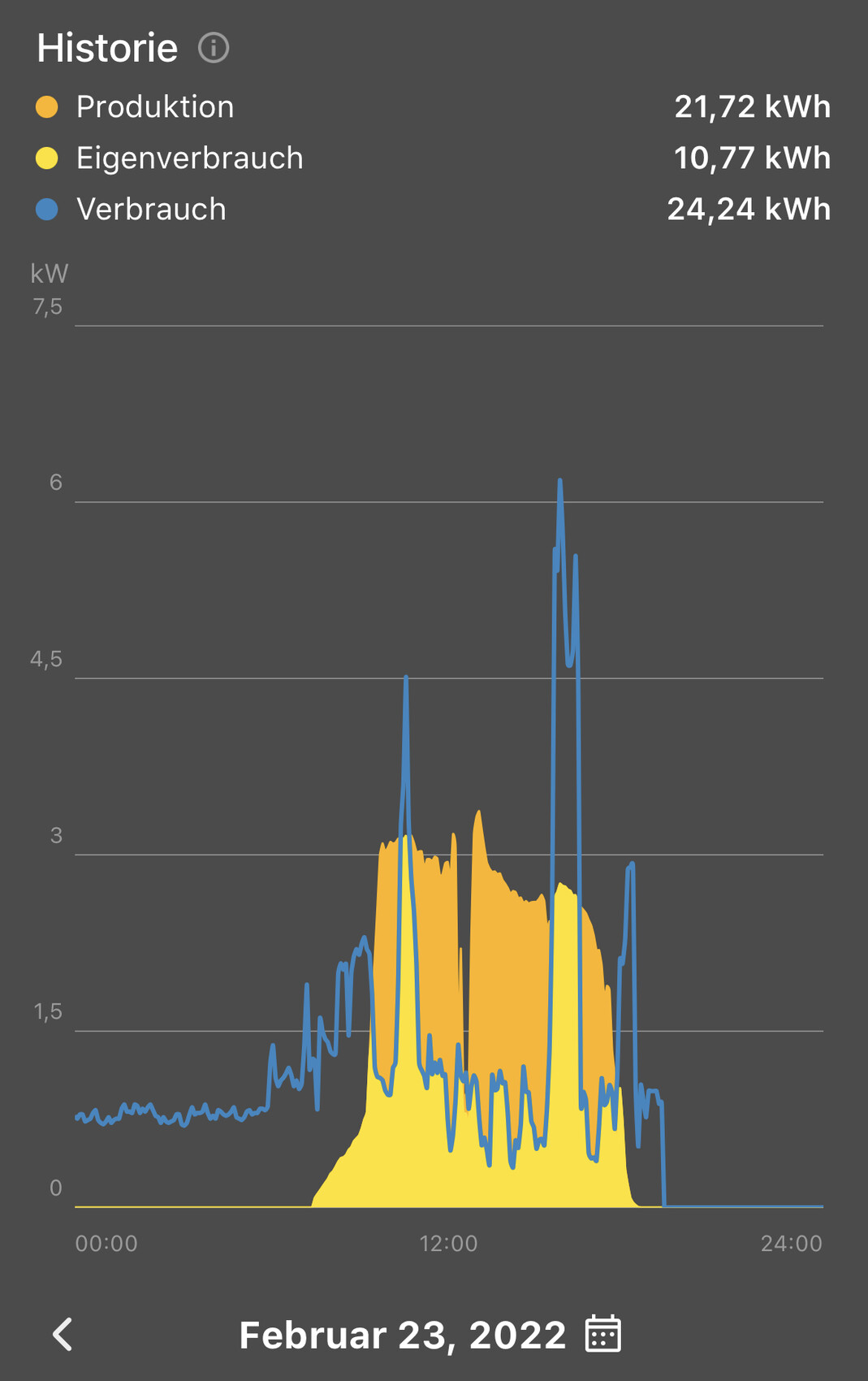

With bidirectional charging, the same question applies: How often does the electric car leave in the morning and only return in the evening? Today was very cold, and I generated 38.5 kWh with my approximately 6.5 kWp (kilowatt peak) small system 🙂. Since I was home briefly in the afternoon and plugged in the BEV to “charge with the sun,” my self-consumption is a bit higher than usual. But that’s right, I have photovoltaic at home, and the car stays at the company 🙄. I always regret feeding electricity into the grid instead of charging the car. The next office starting in autumn will likely get two systems of 30 kWp each :p

Deliverer23 Feb 2022 20:04i_b_n_a_n schrieb:
It is possible, but unfortunately politically (still) not supported and therefore "prohibited" There will need to be a lot of progress in the coming years. So I have not given up hope yet.
