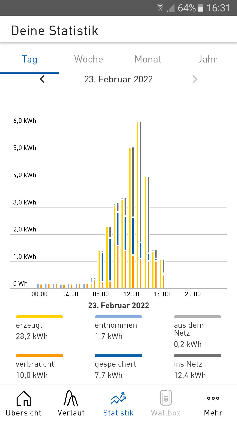

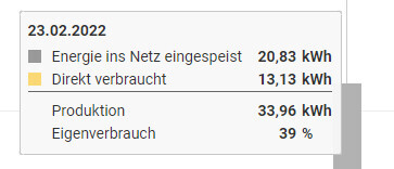

Benutzer20023 Feb 2022 18:38Mahri23 schrieb:
A new house with the right photovoltaic system is really enjoyable.I can only agree – and that in winter. It gets even better on the weekend:Similar topics
