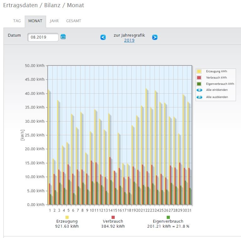

boxandroof2 Sep 2019 16:40We have completed the first full month. 10 kWp, with 75% facing south and 25% east/west. One module is not yet operational.
1206 kWh generated
188 kWh / 16% self-consumed
1018 kWh sold
67 kWh purchased (74% self-sufficiency)
Heat pump used for hot water / some cooling (31 kWh), and household appliances are mostly scheduled to run during the day with a timer.
