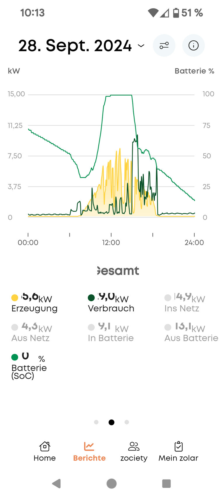

Pete1909 schrieb:
From 3 p.m. onward, we had full sun on the other side today, lasting until the evening.In winter, this reduces to around 3–4 p.m., so it’s not really worthwhile.The yield today and on Saturday with the sauna (yellow = photovoltaic, black = consumption, green = storage)
