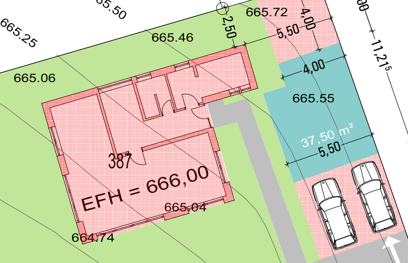

WilderSueden8 Nov 2021 22:56That makes me a bit more relieved. I discussed the topic today with the engineer responsible for the building application, and he also sees no problem. Not much water would run under the house. As a precaution, he suggested side drains along the path, but I suppose that’s not necessary with permeable paving here.
I’ve attached the elevation profile. Unlike in the picture, we will go to 665.5 m (2,182 ft) now, which still places the front door above the ground edge, and with a proper gutter that should be okay. The critical area really is just around the front door; the rest should be unproblematic if the filling is done sensibly.

If you want to protect the area directly next to the house with a channel drain, it should have a high capacity and be connected to the sewer system (if allowed). I’m not trying to advertise, but you can find a full range of options under drainage systems by Richard Brink.
