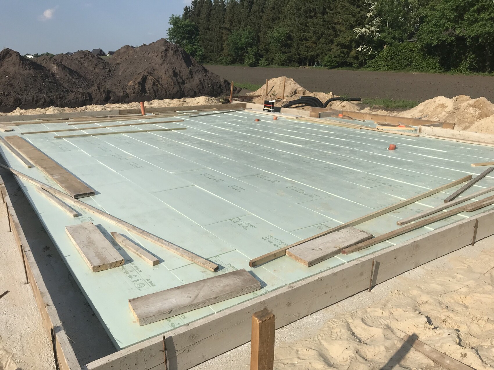

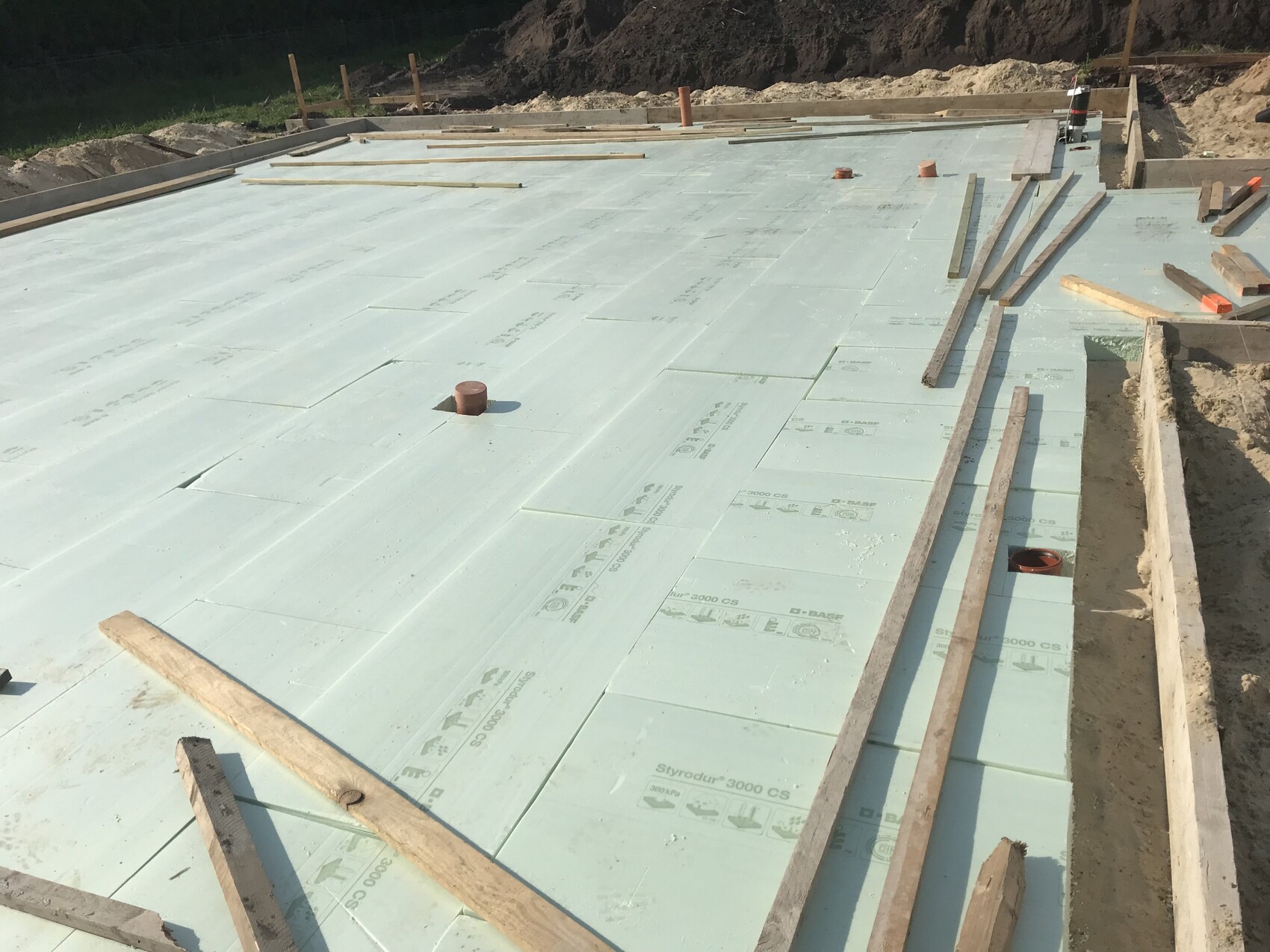

Our house construction is getting closer, but today I noticed something that I don’t quite understand. Maybe someone can clarify it for me.
Under the concrete slab (according to the structural engineer 180mm (7 inches), but probably going to be 220mm (9 inches)) there is supposed to be an 80mm (3 inches) perimeter insulation (125m² (1,345 ft²)) installed. The floor build-up according to the architect looks like this:
5mm (0.2 inches) carrier board
120mm (5 inches) wood fiberboard insulation, thermal conductivity class 035
20mm (0.8 inches) wood chipboard insulation, thermal conductivity class 035
10mm (0.4 inches) waterproof membrane
Now my question is:
Isn’t this a bit redundant? Wouldn’t just the 120mm (5 inches) XPS insulation board above the slab be sufficient?
It will be a standard house built according to the 2014 energy saving ordinance.

First of all, Steven is right. We are talking about relatively small savings. However, without insulation beneath the foundation, it will not get damp because a bituminous membrane is applied on the concrete as a barrier. On top of that comes the screed insulation, and finally the screed.
