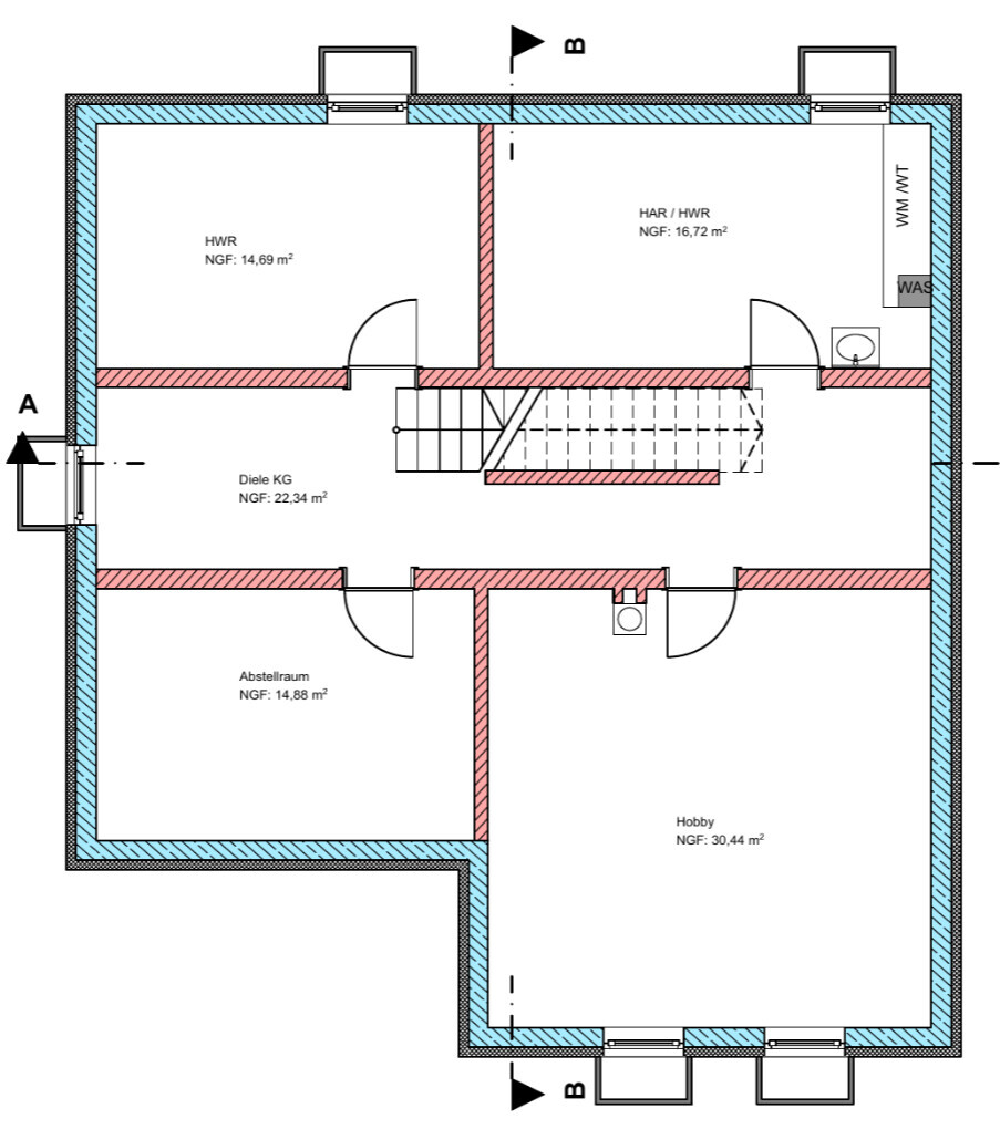

Here is the shown basement floor plan. White tank waterproofing.
Basement level: hallway, utility room, HVAC/utility room, storage room, hobby room, laundry room, staircase
We are currently gathering offers for the shell construction (not a general contractor) and are still in the early planning phase, so nothing is set in stone yet. A specific KfW energy efficiency class is not planned due to lack of funding.
Heating will probably be done with an air-to-water heat pump. Only the hobby room in the basement will have underfloor heating.
One of the shell builders plans no insulation under the basement floor, while another proposes 12 cm (5 inches) of perimeter insulation.

Opinions differ widely on this topic. If you are planning the basement purely as a utility space and are not applying for any subsidies, I would suggest calculating the actual extra costs involved. It’s not just the insulation boards but also the additional excavation material and possible disposal fees. We have a guest room with a correspondingly large window and underfloor heating, which is why we decided to insulate. I also recall that the prices for XPS boards noticeably increased when we installed them.

There are few areas where you can have a significantly greater impact on the overall energy balance with comparatively little money. At the same time, there are few areas where retrofitting later would be more difficult. In other words: do it. As thick as possible / affordable.
Also consider using the floor slab itself as a heat or cold storage (BKA or thermal slab). With relatively little effort, you can make your heat pump even more efficient and only need to forgo underfloor heating in certain areas. It is also conceivable to completely omit screed in the basement.
Of course, this only makes sense if the perimeter insulation is installed without any gaps and properly connected to the exterior insulation.
