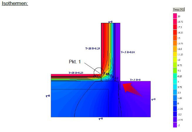

I mean on the outside of the 24cm (9.5 inches) high side of the foundation slab

You need to ask your designer that question. Basically, this area is probably the most sensitive part of the entire house. Because of the concrete slab floor, a thermal bridge often forms in this area. Especially in the base area, you can quickly get condensation and therefore mold.

I am only concerned with the practicality.
I found this image on the internet and marked the insulation in question with the arrow.
If I interpret the image here correctly, it seems relatively pointless?
