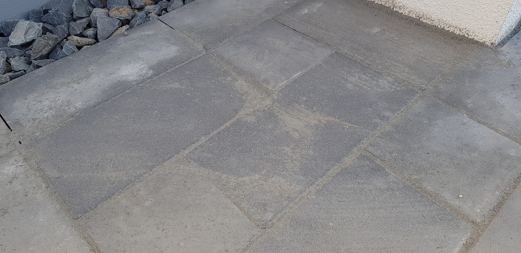

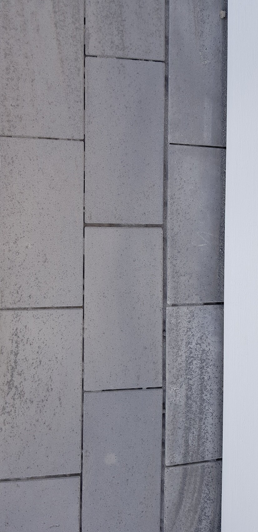

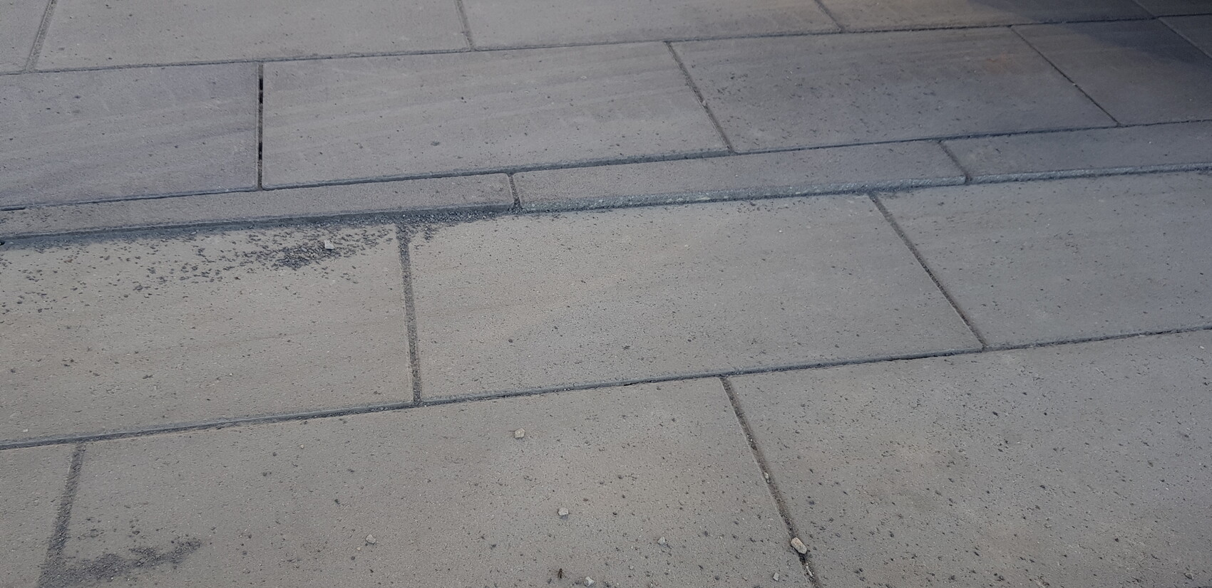

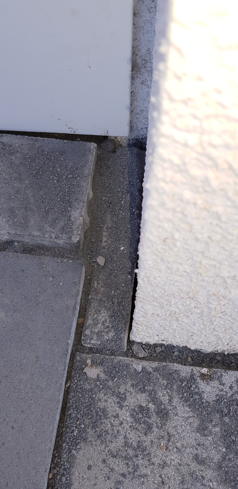

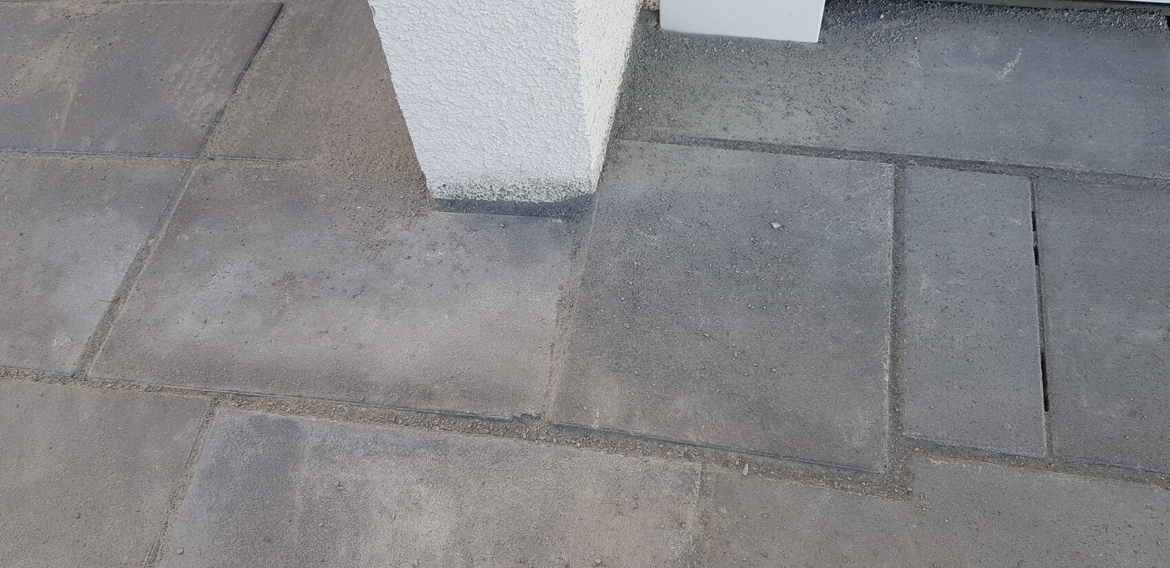

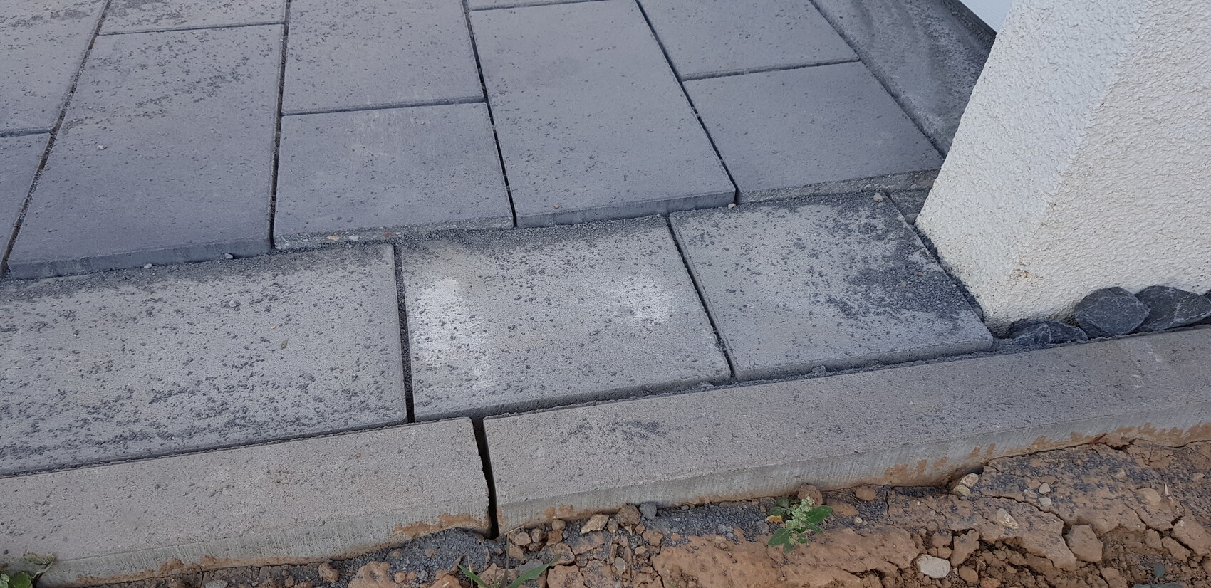

we hired a landscaping contractor for our outdoor area. Among other things, he paved the driveway and the area in front of the house.
Unfortunately, the paving work did not turn out as we had expected.
I have attached a few photos.
The problem is the uneven height differences in several places.
Does anyone have experience with this? Which DIN standard can I refer to with the company?

I can hardly see most of the height differences in the photo. I believe anything under 5mm (0.2 inches) cannot be claimed, but someone with more expertise should weigh in on that. However, I also wouldn’t accept loose concrete slabs!

Once it has been compacted, the stones will hardly penetrate anymore, possibly only about 1–1.5mm (0.04–0.06 inches).
Overall, this is really poor workmanship...

Okay, attempts to fix the issue (I think it will only stay at the attempt stage) are understandable and should be allowed.
But I wonder, what exactly does he want to vibrate?
The gravel base wasn’t properly leveled, and the paving slabs (sorry) were carelessly laid. This won’t work anymore. The slabs need to be removed, the gravel base properly leveled, and the slabs reinstalled.
What kind of jointing compound was used here?
I assume your landscaper doesn’t know what he’s doing. Happens quite often. A neighbor of mine also works as a landscaper, often doing undocumented work. But he’s always incompetent. The internet is full of negative reviews about his sloppy work (you should check your landscaper’s reputation in that regard).
