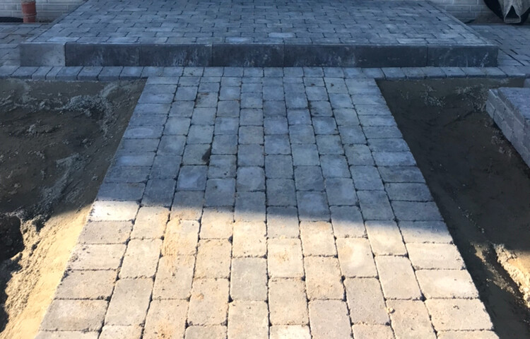

I wouldn’t recommend doing that for driveways.
The weight of the car pushes the paving stones aside. I would rather set the edges, which will be mortared, a bit deeper.
Thin metal/thick metal.
Thin sheets like lawn edging metal won’t hold heavily loaded stones in place over time, while thick metal sheets can’t be easily bent. They also won’t hold the desired curve firmly but will spring back straight again.
You could mortar the metal sheets deep into the ground, but then you’d need to apply counter pressure until they are fixed. That would be one option. But then the metal sheets would be redundant, since you could just mortar the paving stones directly.
You will still need to cut the paving stones, which will be a tedious task.

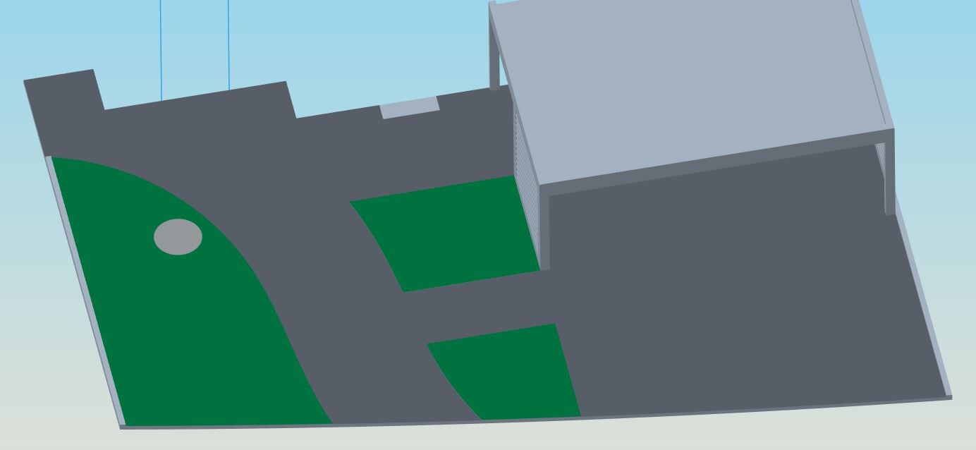

Yes, I had thought about embedding the 15-20cm (6-8 inches) high metal sheets with back supports on both the front and back in concrete. I assumed that this would prevent any movement. I like it when the separation is not visible.
Alternatively, we could use a paving stone placed at a 90° angle to create the border. That would also be possible.
Well, I just want to gather ideas for now. They definitely should not be curbs.
I am aware that the curved outline also has some disadvantages, but I have already drawn it and think it fits well.
Attached is a sketch.
On the left, you can see the cistern cover. That area is planned to have reeds, pampas grass, and shrubs, covered with lava granules, so I can still access the cistern. On the right is the carport that will be built in front of the garage. The two other green areas will be planted to reduce the large paved surface (after the green area, about 130m² (1400 sq ft) remains).

There are probably also beveled edges, but I don’t remember the exact term and am not sure if they are suitable for curves. Maybe turf edging or something like that? We didn’t install them because there is so little topsoil above them that the grass tends to die or dry out easily. But they might be suitable for planting beds?
