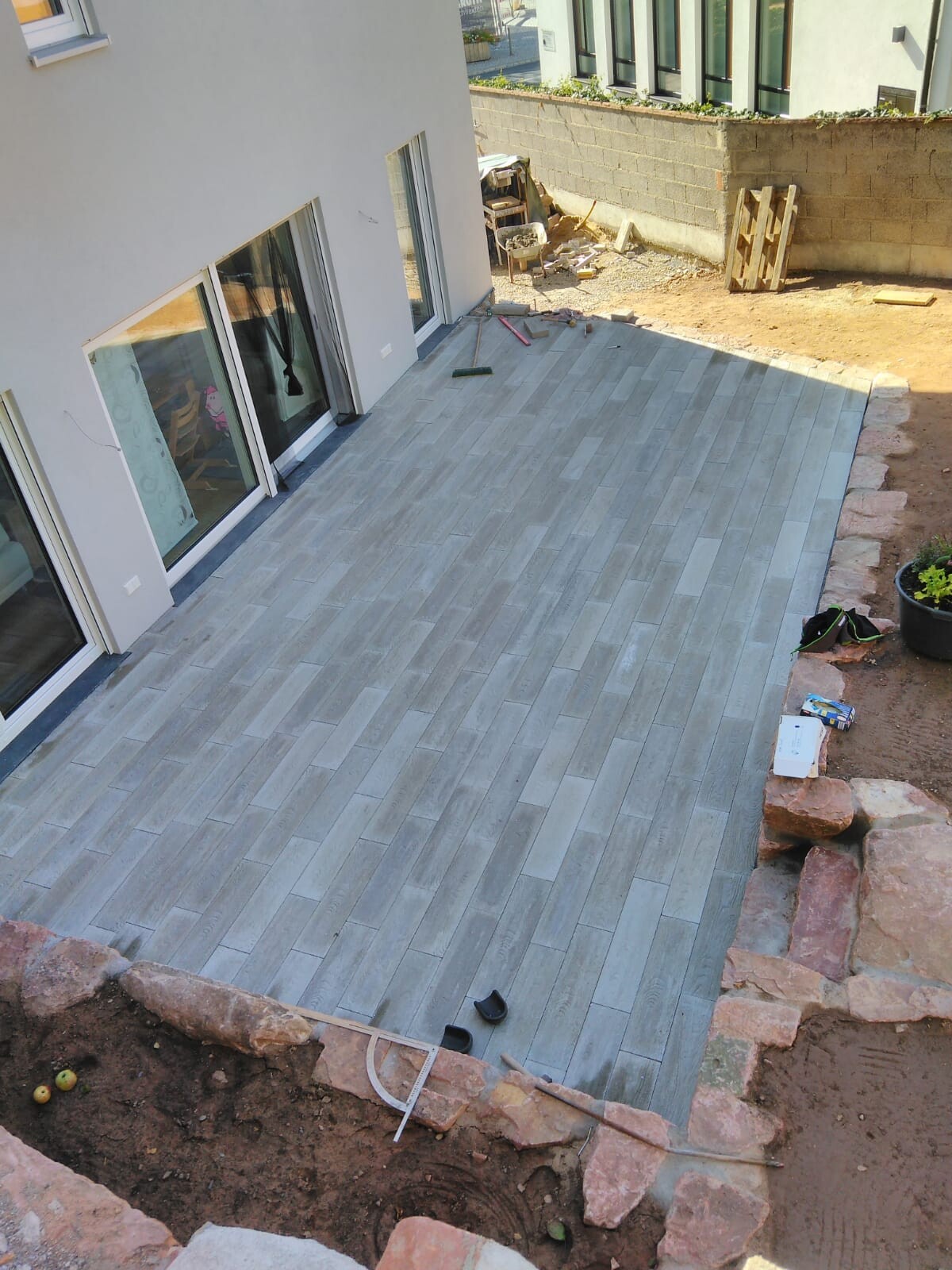

@haydee
Yes, exactly like in the picture.
