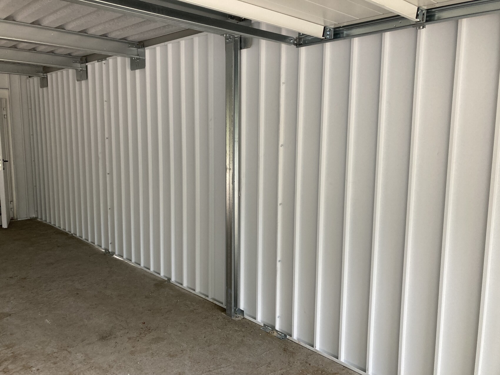

I think there are different profiles for steel garages. Maybe you have different ones than the original poster and me. (take a look at the pictures)
Gluing might work for light switches. For sockets, the forces from pulling and pushing would be too strong for me.
I cut a piece of OSB board to fit, glued it into the steel profile, and as a precaution, screwed it in from the side, then mounted the sockets and switches on it.
motorradsilke3 Sep 2021 12:58Musketier schrieb:
OT
How do you screw it onto 1mm (0.04 inch) sheet metal? The screw would stick out on the outside.
I think there are different profiles for steel garages. Maybe you have different ones than the OP and me. (check the pictures)
Gluing might work for light switches. For sockets, I think the forces from pulling and pushing would be too strong.
I cut a piece of OSB board to size, glued it into the steel profile, securely screwed it on the side just to be safe, and mounted the sockets and switches on it.You can screw it onto the vertical intermediate profiles. Or the screws will stick out if it’s on a hidden side. And these days there are such great adhesives that nothing will come off.
