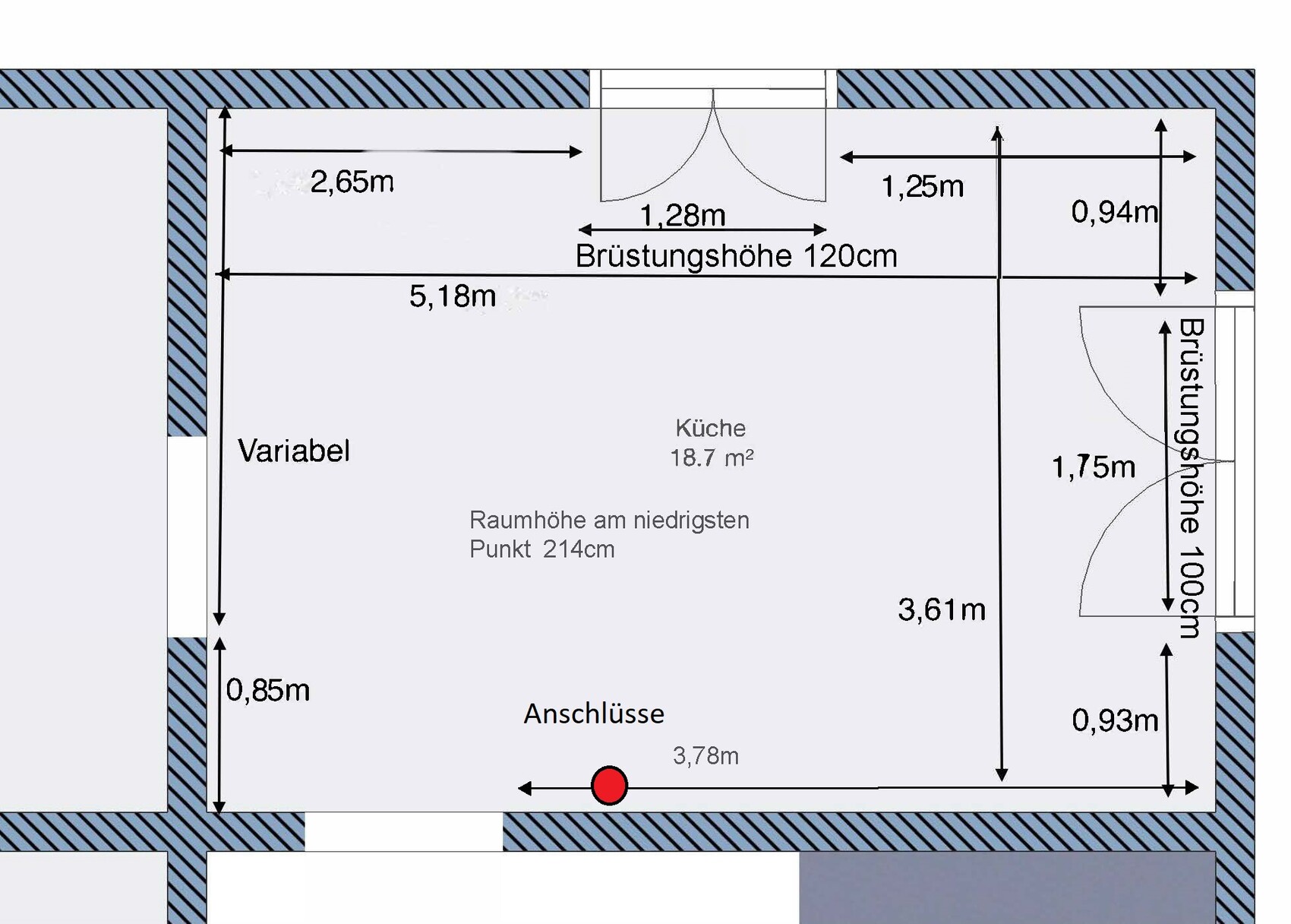

The current kitchen layout looks like this:
Sink positioned at the bottom of the plan to keep plumbing runs as short as possible.
The right wall in the plan is not really an option for a countertop, since structurally we can’t extend the countertop into the window. Also, leaving a 2 cm (0.8 inch) gap under the window sill looks awkward (the countertop height is 98 cm (39 inches)).
evelinoz schrieb:
You can’t have the sink at the bottom of the plan and the cooktop 3 meters (10 feet) away.You can, but whether that makes sense is another question. For us, no other layout made more sense.And doesn’t a 100cm (39 inch) parapet height conflict with a 98cm (39 inch) countertop height in your opinion?
I would want to use the island purely as a work island, so the stove opposite would be a bit cramped, but maybe still workable?
One of the corner cabinets is dead space, but that’s manageable.
Is it possible to extend the wastewater drain by another 2 meters (6.5 feet)?
