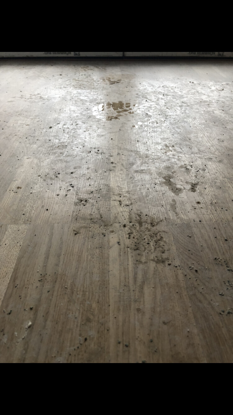

I’m moving into my new build on March 1st and have the handover with the builder on Monday.
The hardwood flooring was “included,” meaning the builder had it installed. For the past 4 weeks, it has already been subtly subjected to wear and tear—there are small stones, sand, dirt everywhere, and thousands of scratches. I’m trying hard to stay calm. Despite reminding the builder twice, the flooring was not covered. So I covered it myself. Yesterday, it was scrubbed by a “non-expert,” as the person himself said, using a neutral cleaner, which of course rubbed the dust and dirt in even more. My patience is running thin.
Anyway—I also noticed yesterday that some areas look “carelessly” done and some corners appear a bit worn. I’m not a professional and don’t know if this is normal.
I definitely don’t want to be picky or exaggerate, so here’s my expert question: is this result within a “normal” range or is it poorly executed?
Thanks a million in advance!

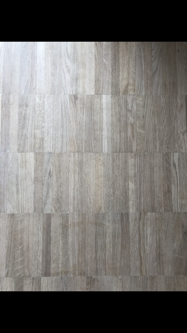

delilah2623 Feb 2019 21:23
Domski schrieb:
Please provide 1-2 overview photos. I’m not familiar with parquet flooring installed without staggered joints, and except when the manufacturer allows it, this is generally not considered proper practice. The visual impression from the pictures is worn.
I would reject the acceptance of the parquet.
Thank you for your reply! I also have the impression that it looks worn. It is mosaic parquet laid in a straight joint pattern, and according to the installer, no staggering is needed. He was from Romania and spoke only English.

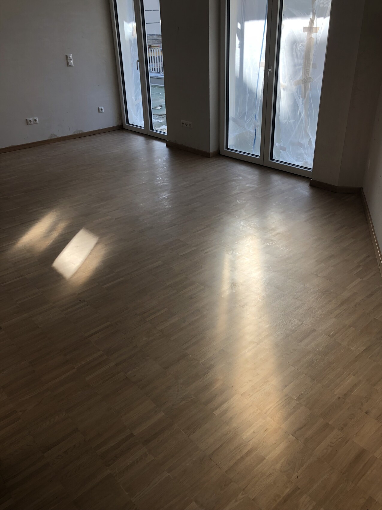

I have attached another photo from above, as well as one from the manufacturer, to give a better sense of the scale.

delilah2623 Feb 2019 21:54
Yosan schrieb:
Please take a photo that shows an overall view. From the current pictures, it looks quite worn...
I took a photo from further away earlier, but unfortunately, you can’t see anything from that distance. From there, it appears superficial and at first glance might seem well done. However, when you look more closely, the originally posted photos come into view.

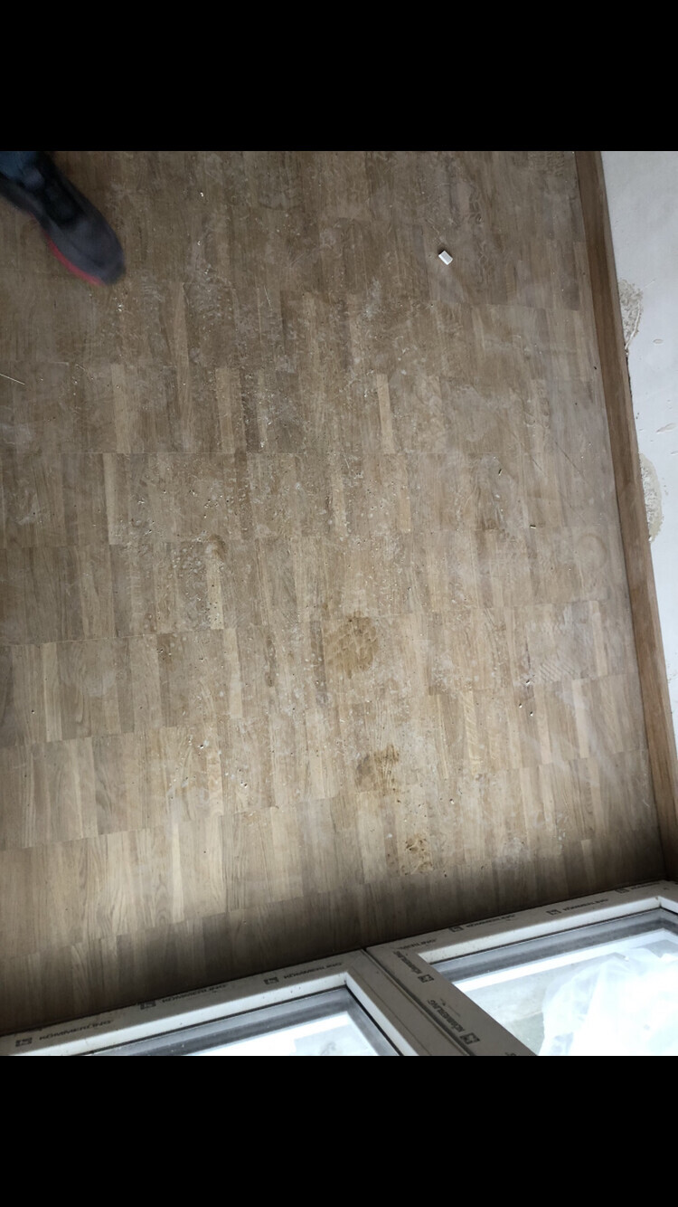

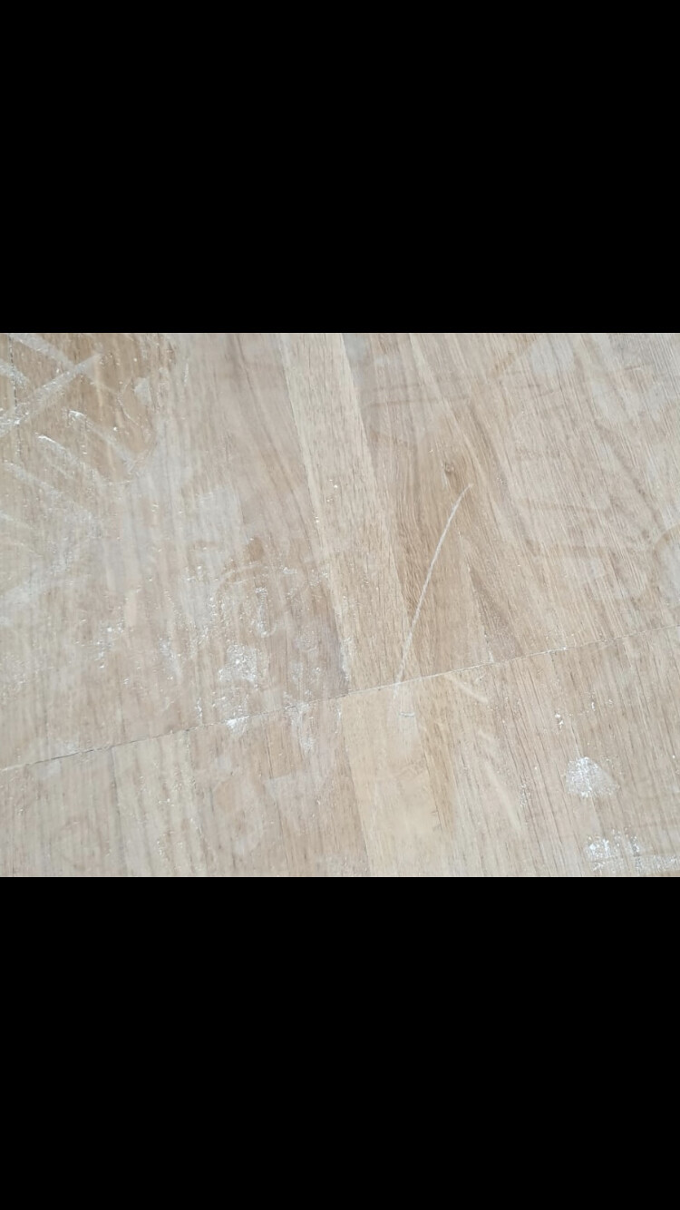

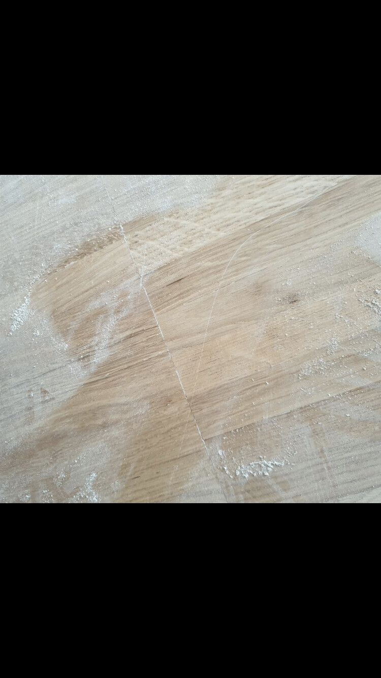

Besides the unsightly joints, there are scratches. And by Friday, there will probably be more. This is how it looked yesterday, as an example:
Wood floor indoors with wet spots, dust and dirt
Wood floor with dust and flour residues; a diagonal wood seam visible.
Light wood floor with dust, white spots and scratches.
Dusty wood floor with stains; small white square, dark shoe in corner; window frame.
Under these circumstances, I will definitely demand remedial work first, if that is possible!
