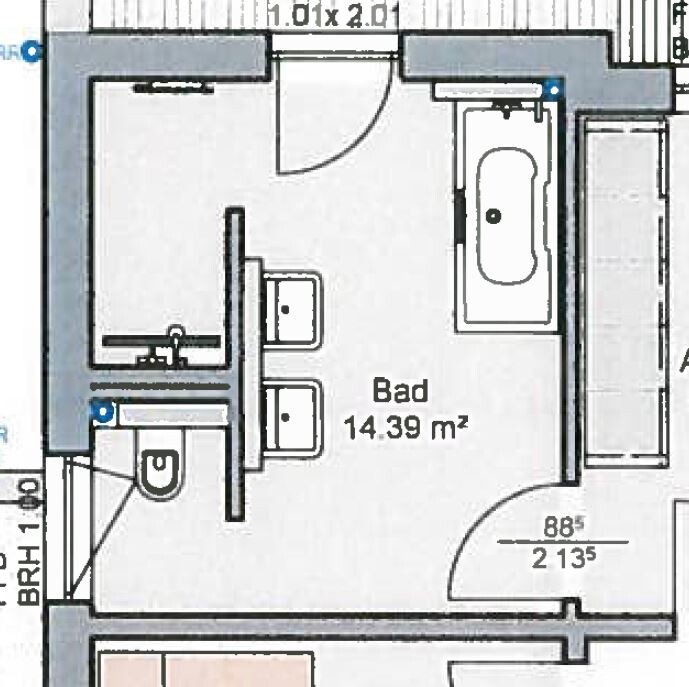

What do you think about this master bathroom layout?
We didn’t really want the shower to be so hidden since we plan to outfit it in a high-quality and stylish way. It would be nice if it could be more visible, not just for showering. But during the plumbing planning, we were advised to keep it like this (because of the water pipes).
What’s your opinion? Or does anyone have an idea on how to create more visibility into the shower?
The two washbasins are marked incorrectly. We will only use one washbasin (1m wide (39 inches)). Our idea is to move the bathtub to where the washbasins are currently shown and place the washbasin on the right wall instead. We want the bathtub to have a prominent spot in the room instead of being “in the corner” when we bathe.

Not this. But I think the solution is good now, and anything that might still be critical can easily be identified during the shell construction phase. For example, the washbasin is slightly less deep than shown in the plan.

In our bathroom, there is a pre-wall installation in front of the washbasin wall. Do you have the pipes inside the narrow wall?

It doesn’t really change anything, but the shower would be way too dark for me. And honestly, I really don’t understand how someone can criticize the T-shape layout so much and then praise (what I see as) nonsense with the sink placed there. To install a mirror, the wall has to go all the way up to the ceiling, which significantly reduces the light. Also, I find that little stub wall unbalanced in terms of proportions. I don’t get the “long” distance from the toilet to the shower either. In a room that’s 4m (13 feet) wide, making such a long path seems a bit funny. Besides, 4m (13 feet) is just a few steps — how often do you really take that long of a route? Kitchens have way longer distances, and nobody minds walking around (half-)islands.
I prefer bright spaces, and especially with the T-layout where the bathtub is in front of the T, the advantage is that the T-wall is only about 1.20m (4 feet) high and acts as a privacy wall for the toilet, meaning it’s open above and lets the window light into the room. On the shower side of the T, you can place a nice glass element, which again brings lots of light into the shower. Also, you don’t feel the 40–60cm (16–24 inches) height of the bathtub as restricting — if anything, the room feels more spacious than with the current solution featuring a closed-off shower and a toilet L-shape layout. The window at the top of the plan also makes the room nicely bright. The sink positioned at the top-right would be great. You could sit on the bathtub edge while brushing your teeth and look out the window. For shaving or make-up, you won’t use daylight anyway — it’s coming from the side, but still closer to the sink than it is now. Instead, the (artificial) mirror lighting will take over...
I think the criticism against the T-layout is really silly. You don’t have to like it, which is fine, but using the fact that this layout is common as the ultimate argument against it reminds me of people trying too hard to be cool by wearing unknown brands with full conviction, only to suddenly hate the same clothes and people once it gains popularity among the masses. For example: Naketano — once a totally niche and cool brand, then suddenly available at major stores like P&C, Karstadt, Breuninger, and instantly it’s no longer cool and the wearers are “mainstream”... kind of like the T-layout. That’s just my impression...
@Hotzenplotz: The important thing is that you like it, and it seems you do. So all good. My impression is just that the initial idea wasn’t bad and you were on a good path. Either way, enjoy your bathroom!
