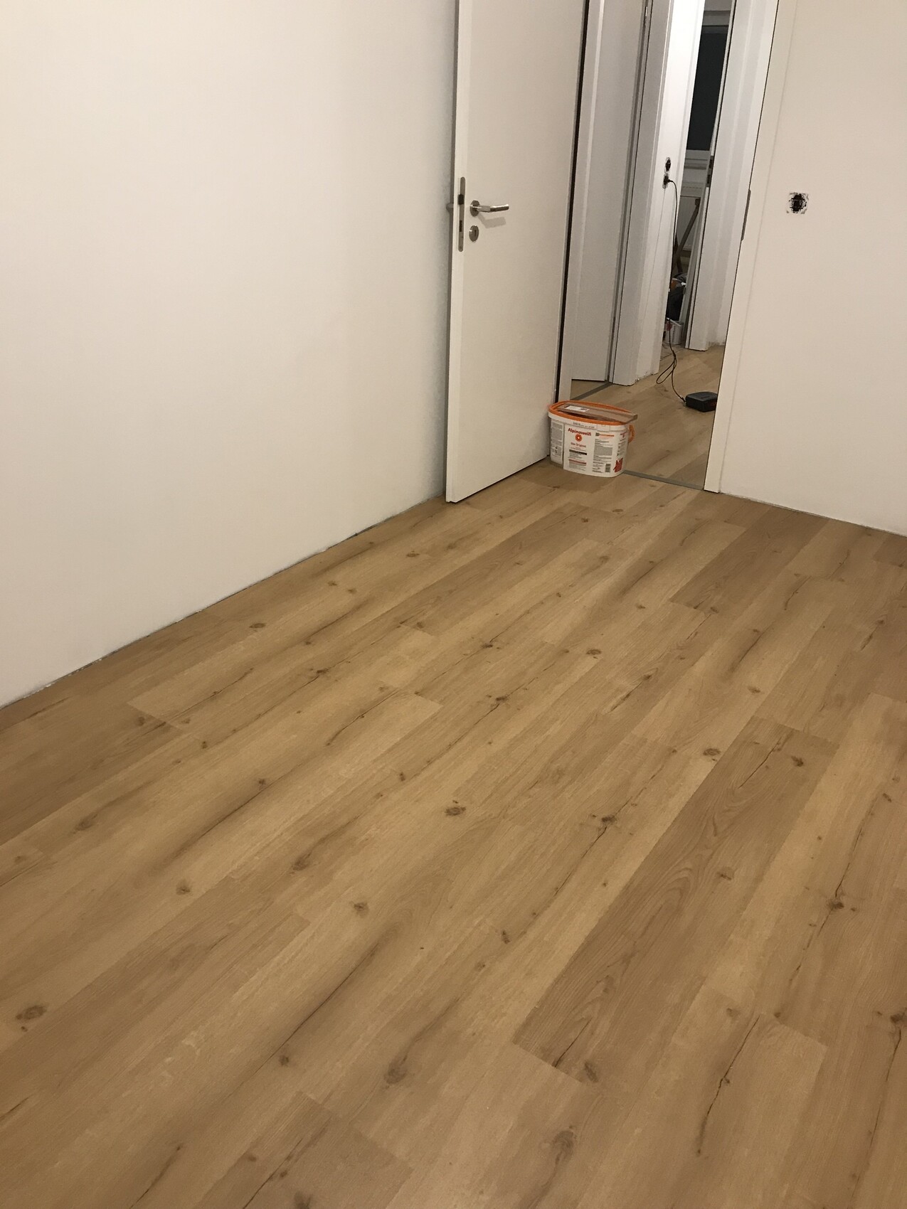

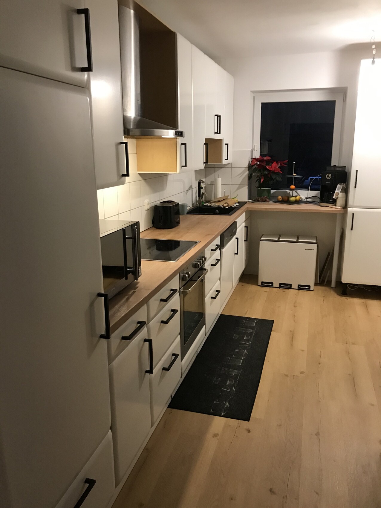

We have the Basic 4.3 Oak Infinity Natural. Hello,
We are planning to install the same vinyl flooring. Do you happen to have any photos of how it turned out for you?
Regards, Sven
