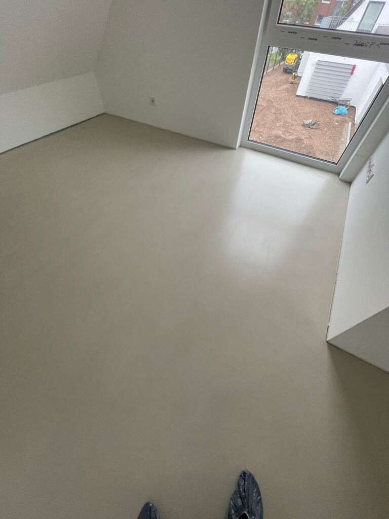

Hi, we had a Pandomo floor installed. The color was supposed to be light gray. It was, until the floor was sealed. Now, one day after sealing, the floor has turned completely beige.
Additionally, the floor looks very wavy. Has anyone experienced this? Will the beige tint disappear once the sealant is fully absorbed?
The first picture shows the color before sealing, the second after sealing.

The floor is already uneven without any sealant (Image 1).

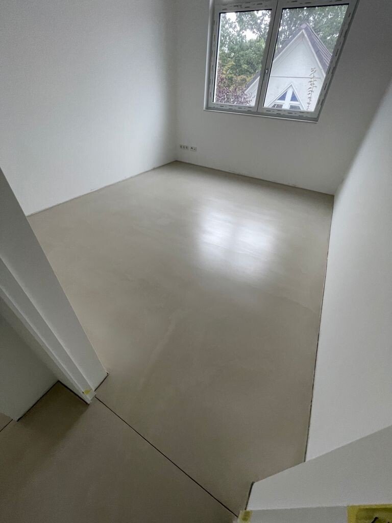

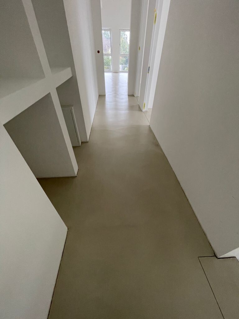

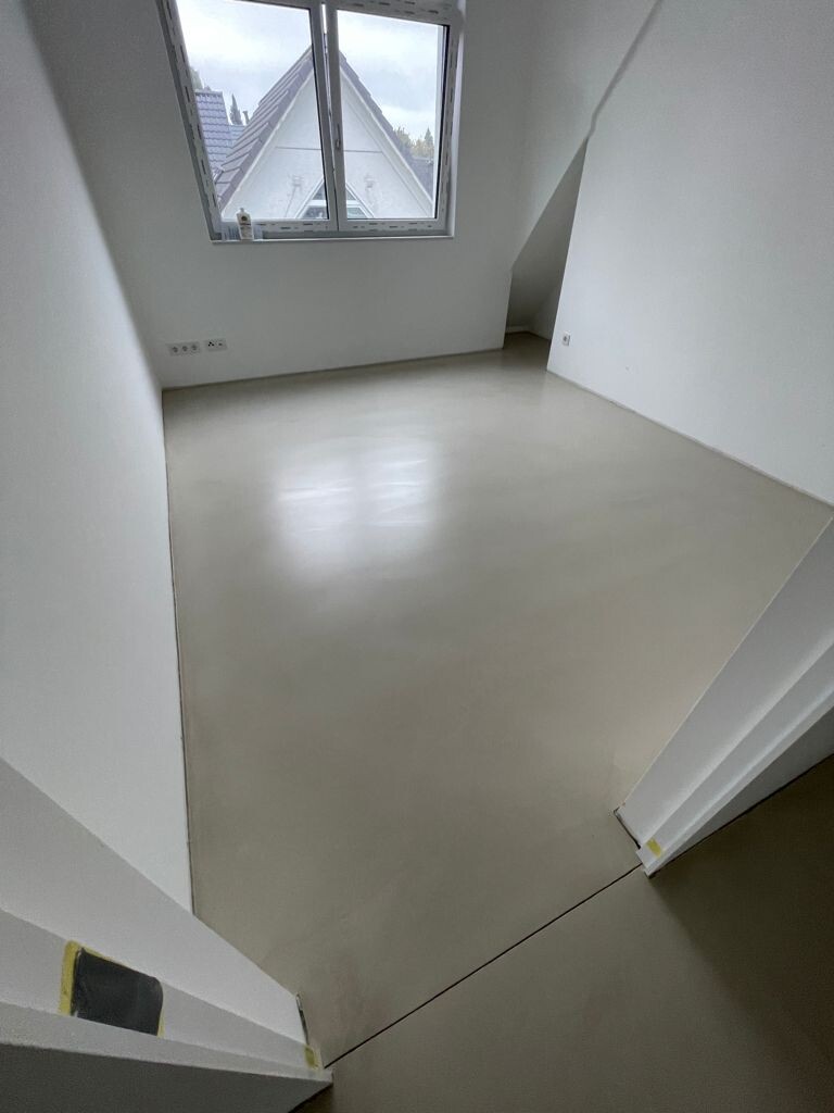

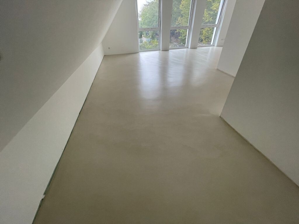

So today I just stepped onto the floor and it doesn’t just appear uneven, there are also dents in 4-5 places!
I’ve also checked the children’s rooms and the bedroom now, and somehow the color and texture vary from room to room!

The waves were already present according to the initial pictures. Who was responsible for preparing the substrate?
The compound is self-leveling, as one user mentioned, but the effect depends on the layer thickness and the substrate. How thick was it supposed to be applied? The waves in the kitchen/dining area (? - first picture) look quite pronounced.
