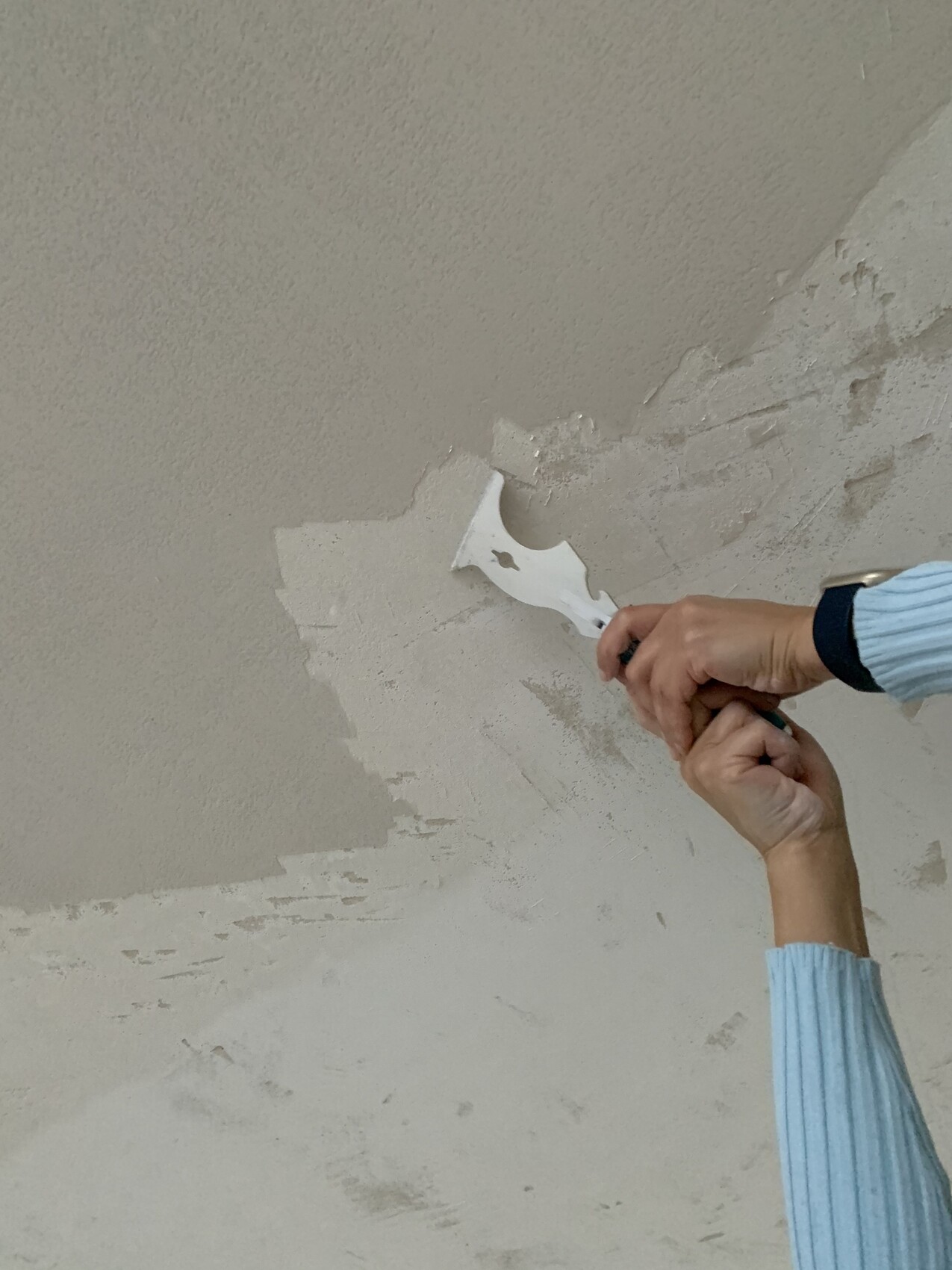

It turns out that the ceiling coating, initially identified by the painter as latex paint, is actually glue-based paint. The latex failed the wipe test with a damp sponge 🙄
Now 70 m² (750 sq ft) of glue-based paint must be scraped off the ceiling 🙁
Even the painter found it too tedious to use the long-handled sander (“the giraffe”), so the ceiling was moistened and scraped off with a putty knife 😡
If anyone knows an easier method, please speak up now...
