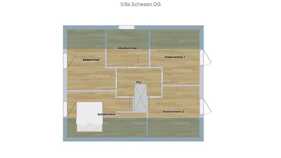

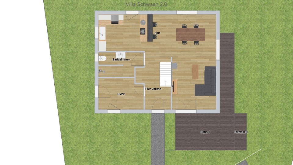

A floor plan is attached for a clearer idea. The house will have 140m² (1507 sq ft) and will be built solidly (masonry construction).

I designed the floor plan myself as a template for the architect. It’s just an approximation (of course, not everything will fit exactly) of how it will probably turn out. Based on this, I wanted to start calculating costs.
