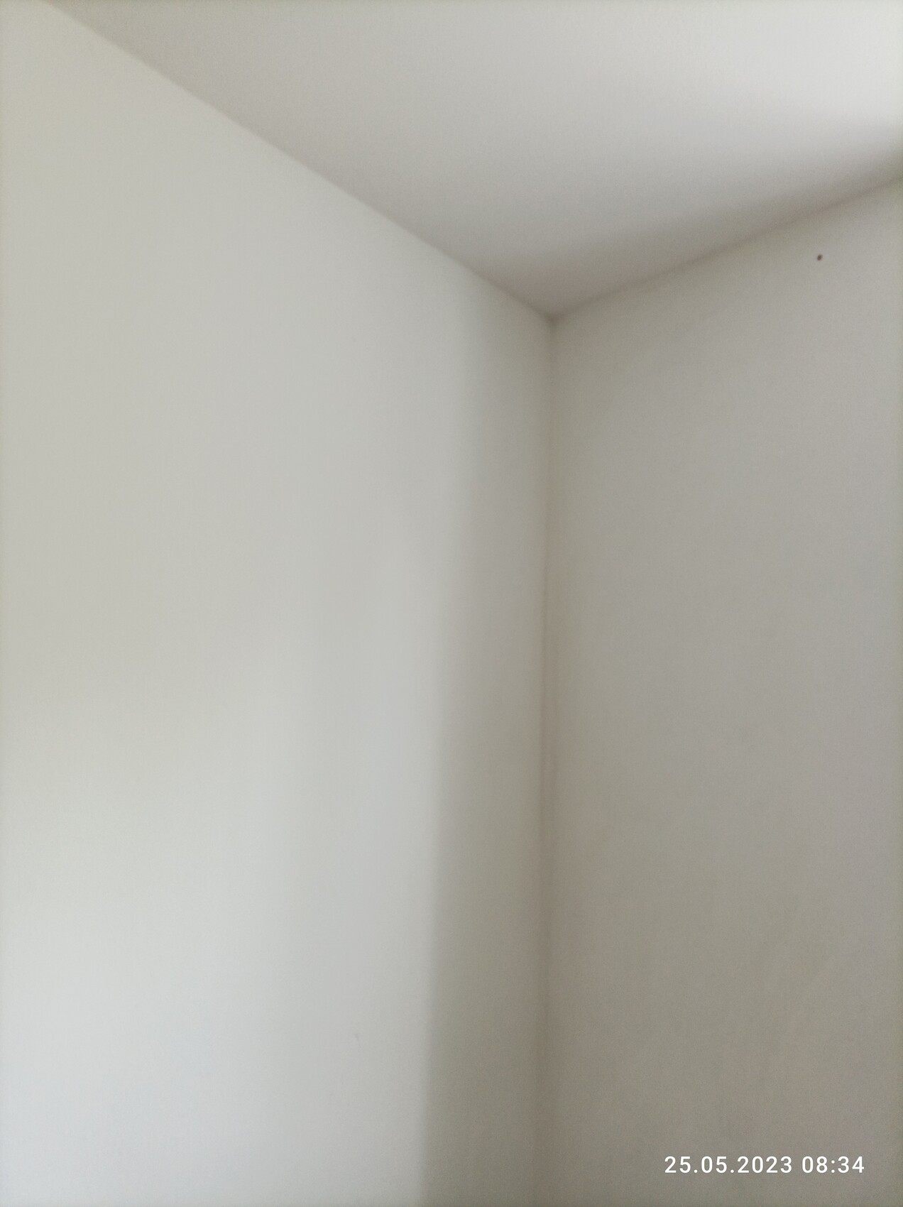

Gerd53
24 May 2023 05:37
The room has been painted with a standard paint purchased from a hardware store. The affected area is the exterior wall and, to a small extent, the adjacent walls near the exterior wall. It does not appear to be mold. There are many small, individual spots. They are brownish in color.
Nida35a24 May 2023 07:36
I would wash off the old paint and repaint with mold-resistant paint. Then, heat the room more effectively.
Gerd53
25 May 2023 08:52
Nida35a schrieb:
I would wash off the old paint and repaint with a mold-resistant paint.
Then heat the room more warmly afterward.
I cleaned the wall with "vinegar water" and a household sponge. The vinegar concentration was very low, less than 1:100 ratio.
The stains are very easy to wash off (see photo). I changed the water several times and rinsed the sponge frequently. At the lower edge of the current plaster area, I immediately removed excess water with kitchen paper towels to avoid leaving a dirty line. This way, even larger surfaces are easy to clean.
White interior corner: two walls meet in an empty room.
