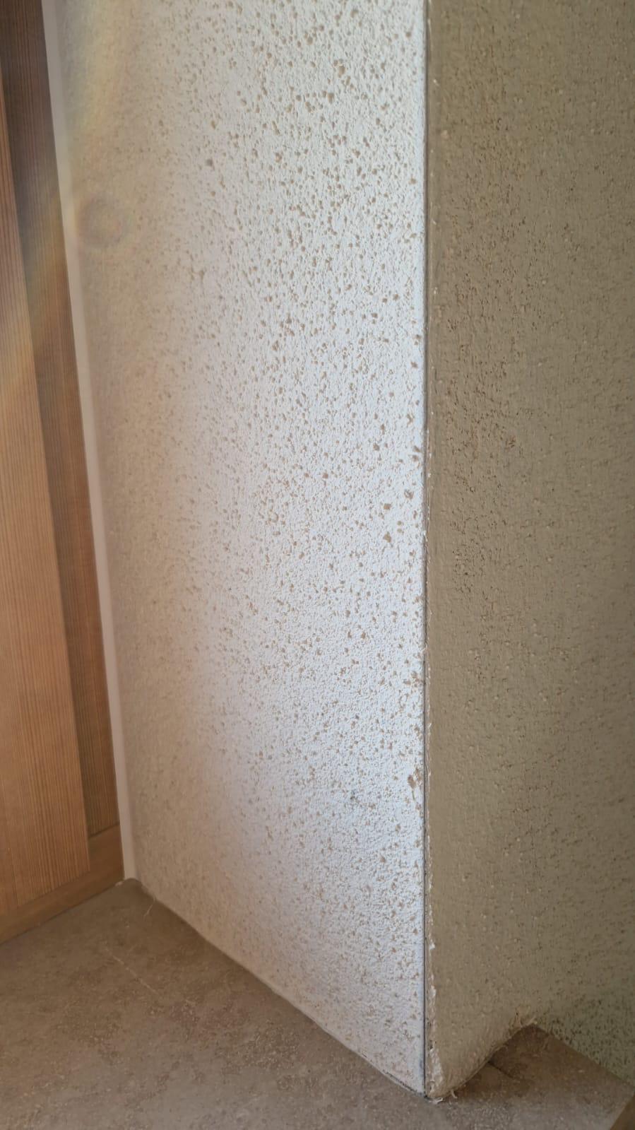

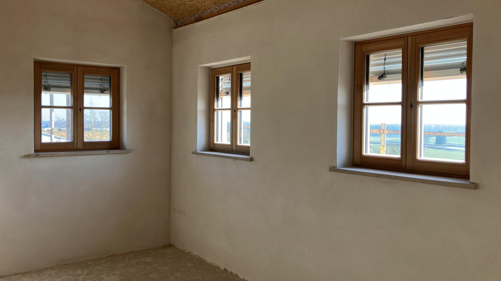

First question: Do you really have pure lime plaster? Or what is being marketed as lime plaster but unfortunately still contains cement? We plastered a few rooms ourselves, and the plaster from a different brand looks a bit different. The other rooms were plastered very uniformly by the professional, with a surface that is quite light but still a grayish beige. I’ll upload some photos for you (I can take more if needed).
I would consider painting for the following reasons:
- The texture is quite "rough"
- The transitions from ceiling skim coat to wall are too uneven
- At windows with corner profiles (not everywhere in our case), the profiles are partially visible through.
As for the color, I wouldn’t choose a bright traffic white either, but rather a shade of white that suits the house style.

familie_s schrieb:
We plastered a few rooms ourselves, so the plaster is from a different brand and looks a bit different.
Is that lime plaster with cotton fibers? Pure lime plaster is usually more like finely troweled render. If needed, it can be finished smoothly to Q3/Q4 level. A matter of personal taste.
familie_s schrieb:
- On windows with corner profiles (not everywhere in our case) the profiles are partially visible.
Honestly? It looks like rough construction – not fully finished. Personally, I find that absolutely horrible if nothing is done about it. But taste is subjective.
