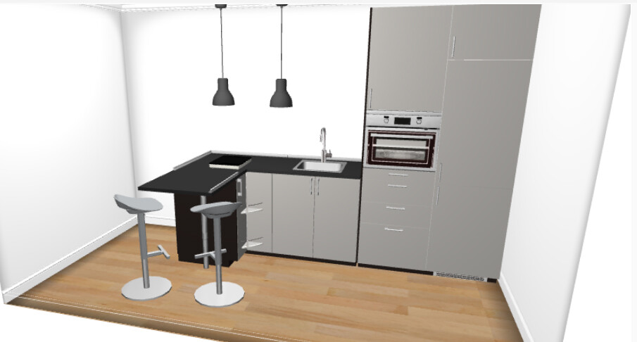

In the apartments for our guys, I have a straight wall with a length of 2.9 m (9.5 feet) where I want to install a small kitchen unit. Both kitchen units should be identical but mirrored in their layout. In one corner, a 24 kW tankless water heater needs to fit inside a base cabinet to supply both the kitchen and bathroom. This unit is approximately 45 cm (18 inches) high, 25 cm (10 inches) wide, and 10 cm (4 inches) deep.
The kitchen should include a sink with a small draining area, two cooking zones, a small oven with a microwave function, and a built-in refrigerator with a freezer compartment. A range hood can be omitted. The ceiling height in this area is 2.45 m (8 feet). It would be ideal to have the microwave device in a slightly taller cabinet at working height.
There should be enough space for basic cookware, dishes, cutlery, glasses, food supplies, waste, and some cleaning materials for the apartment. I’m only getting unsatisfactory results experimenting with pen and paper and curse both the Sweet 3D program and the Ikea online planner equally. Who has the time, interest, and passion to help me?

A quick idea – maybe I’m on the wrong track 😉 IKEA, somewhat modern style with a bar for two, high-gloss gray fronts, sides and countertop in anthracite. Combination oven with microwave, refrigerator with a 79 liter (21 gallon) freezer compartment, separate stovetop – but of course it can also be installed next to the sink. Total cost 2,630 euros all inclusive (appliances can also be bought for the same price elsewhere).
hampshire10 Apr 2019 23:48Fummelbrett schrieb:
A quick thought – maybe I’m heading in the wrong direction 😉 Thank you very much for this draft with the calculation. Interesting idea to place the counter on the entrance side. I’ll be back from the business trip on Friday and will show it to my family.
