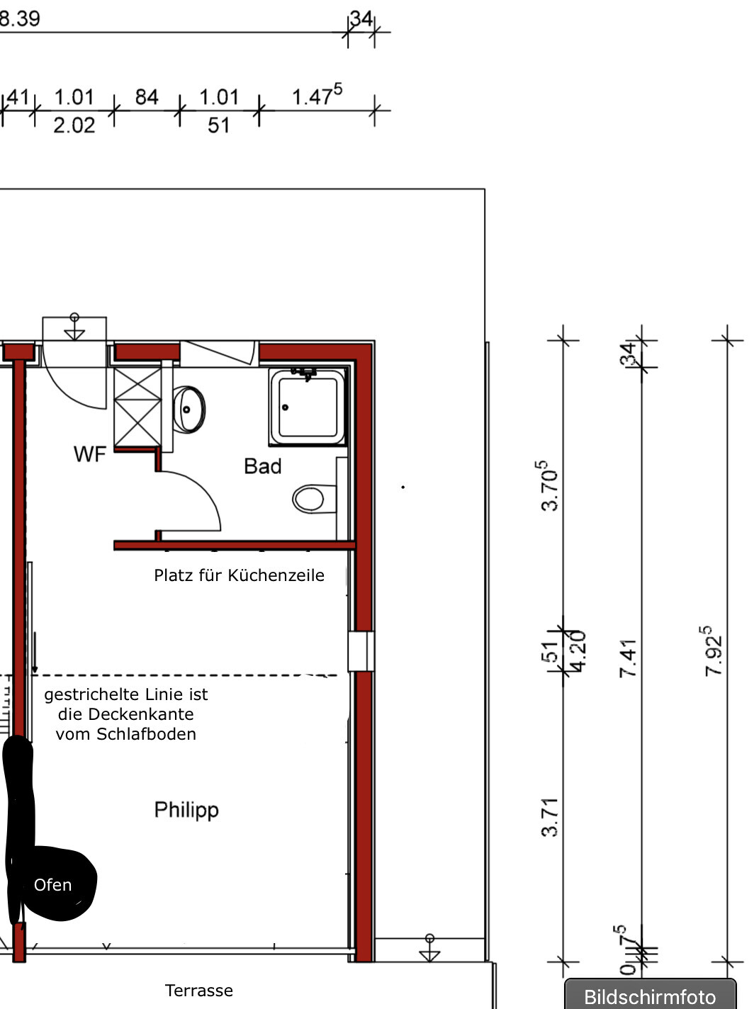

A floor plan with measurements would be helpful. In an open-plan living area, the kitchen cannot be considered separately.
That’s true, a kitchen hood tends to look dirty after less than a month of normal use. However, I don’t think the kids are cooking at the stove every day. So, I would at least prepare everything for a hood but maybe not install one right away if the budget is tight, or wait to see how the kitchen is actually used in the end.

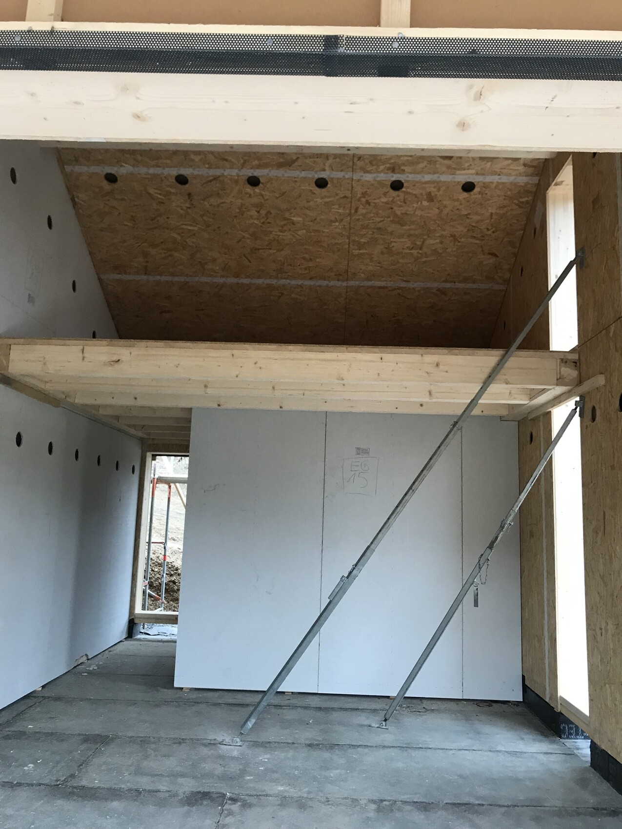

hampshire7 Apr 2019 15:22perth schrieb:
A floor plan with measurements would be helpful. You cannot consider the kitchen separately in an open-plan living area.I put together something; it looks similar to the current layout – the bathroom and bathroom door will be different, but that’s not important here. Above the kitchen is a sleeping loft with space for a bed and a small workspace for a computer. The ceiling height in the kitchen is about 2.45m (8 feet). Since we have two children, we are building two of these living units with separate front doors on the north side and a shared terrace on the south side.
