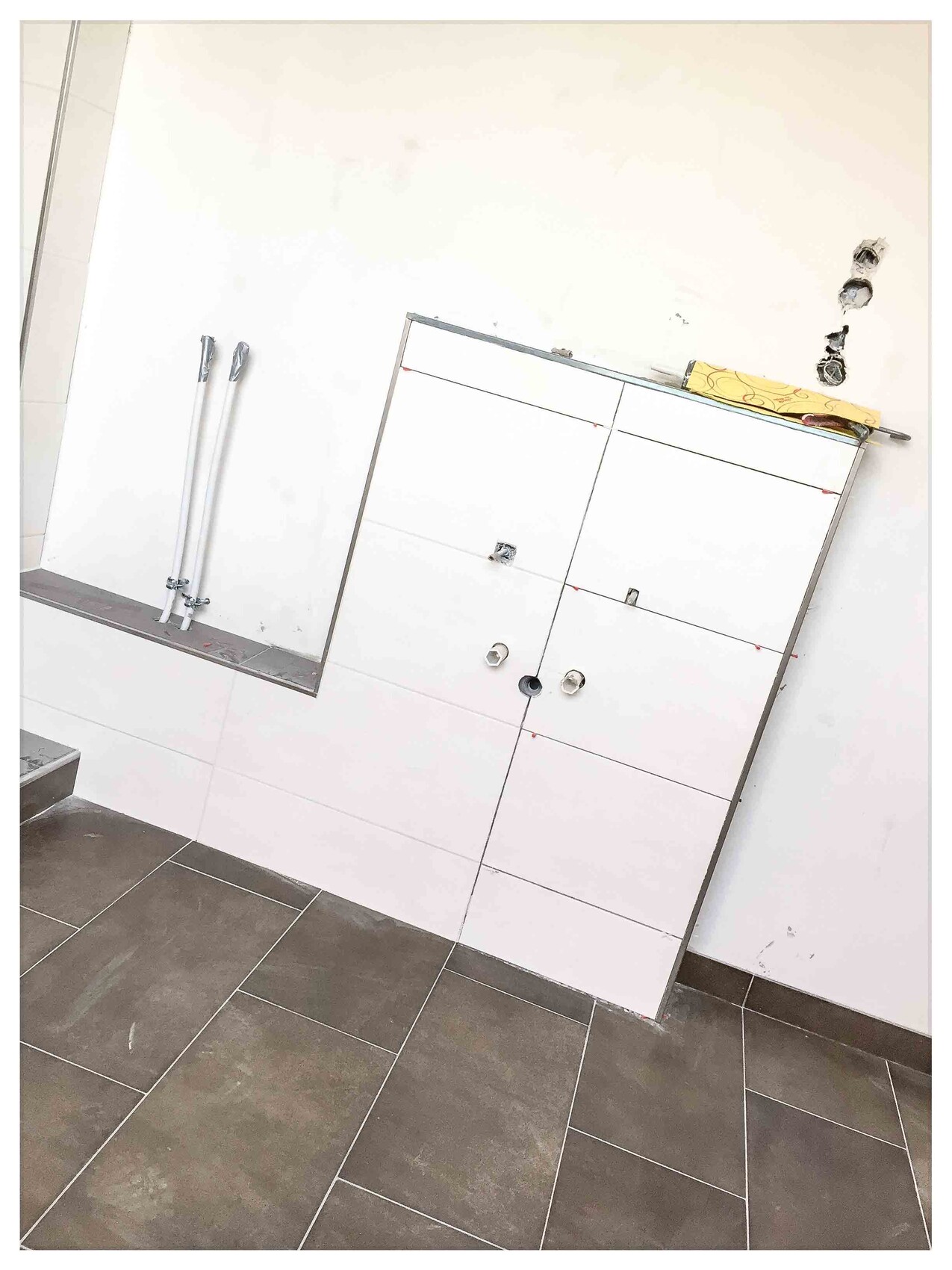

Bauexperte
19 Aug 2016 10:58
... the incredibly expensive washbasin (unimaginable price to me, what kind of materials justify that? Isn’t there a cheaper option without Keuco?) is being removed from the scope of work.
This absolutely requires the plumber to know exactly where to place the connections. 18, 22 centimeters (7, 9 inches) or more makes quite a difference.
daniels87 schrieb:
I let the plumber drill the few holes. With 80x80 cm (31x31 inches) porcelain tiles on the wall, I am careful about that.
Drilling is not really a problem. With a diamond drill bit, a steady hand, and a suitable drill — plus, to be safe, a piece of tape over the drilling spot — anyone who isn’t completely clumsy can manage it.
But surprise — the original poster doesn’t even have to drill; the tile installers will do that for them. After all, the fixings for the washbasin have to be cut out anyway.
Edit: Visual material provided below
Best regards, Bauexperte

Musketier19 Aug 2016 11:02
Bauexperte schrieb:
But surprise – the original poster doesn’t need to drill; the tile installers take care of that. After all, the supports for the washbasin have to be cut out.
Do they have to? In our case, the vanity was simply screwed directly through the tiles (grout lines?).
The only requirement from the furniture store installers for mounting was double drywall layering.
PS: Correction… I meant the base cabinet. I’d have to check how the washbasin is attached.
Bauexperte
19 Aug 2016 11:07
Musketier schrieb:
Do they have to?
It is common practice that the tilers come first before the fine installation.
Somewhere in your bathroom, the cold and hot water connections (sealed with construction plugs) also come out of the wall.
So yes – it also looks cleaner if the tiler is skilled.
