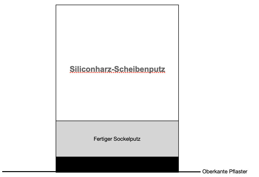

thank you very much for the quick response. The base has been completely plastered and only needs painting now. Unfortunately, during the preparation for the paving, the bituminous waterproofing was applied too high.
Cross-section of a wall construction with silicone resin render on top and finished base plaster below
Attached is a sketch of the facade structure. I would like to paint the black bituminous thick coating and the light gray base.

In the end, you only have two options. Either make the uneven thick coating clean and accept the edge as it is. A properly applied coating doesn’t look that bad.
Or you cut the thick coating cleanly down to the base plaster with a cutter, scrape it off using some of the plaster, and redo the base plaster. At the same time, you can cover the “old” base plaster with decorative stone plaster (what a sentence...).
That’s how I did it. Decorative stone plaster is actually the best option—it doesn’t show dirt and is water-repellent to a certain extent.
You can’t paint over bitumen permanently; nothing will stick.
