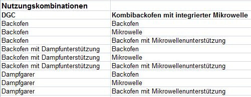

A pure steam oven has very limited applications and is most comparable to steam inserts for pots. The better choice is a so-called combi steam oven, which combines a steam oven and a conventional oven. It offers the standard functions of both appliances, but what really makes it interesting is the ability to use both modes simultaneously. This allows you to prepare dishes in the same way professional kitchens do with combi ovens.
Together with an oven that also includes an integrated microwave, you then have all possible combinations of use available:
