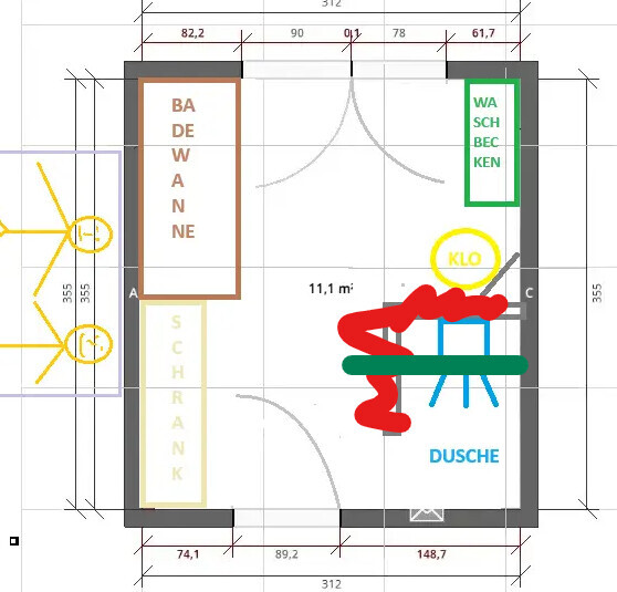

Below is a rough plan showing our current bathroom layout. The measurements are accurate, but the walls are not to scale. Speaking of measurements, we are quite short at 155cm (5 feet 1 inch) and 168cm (5 feet 6 inches) and can manage fine with a somewhat smaller bathtub. Guests or children are not a priority for now ;-)
This is a potential bathtub choice (weight approx. 40 kg (88 lbs)):
What do you think about our plan? The dimensions for both bathtub and shower are 165cm (65 inches) each, which should just fit.. We still need to try lying in the bathtub to be sure :-/

Hi @Besenkammer84 – why not simply separate the shower area with a single wall? That way, you would gain a lot of extra space for the toilet. Even with the wall length, you would still have a generously sized shower. If you want natural light in the shower, you could even make part of the wall glass—though you’d need to be willing to clean it regularly.

Hi @Besenkammer84 – why not simply separate the shower with a wall? That way you would gain a lot of space for the toilet. With the length of the wall, you’d still have a generously sized shower. If you want natural light in the shower, you could even make the wall partially glass. Of course, if you’re up for cleaning it regularly.
We have a half-height wall with no glass on top. But we’re a bit crazy like that.
Don’t you always get a narrow access area (towards the bathroom door) that way? Or where would the shower head go?

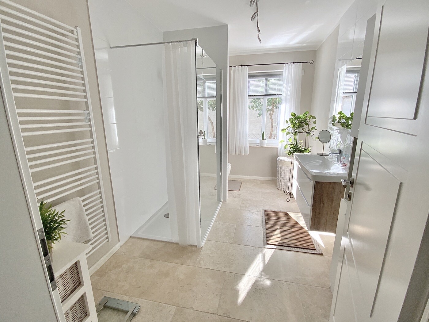

Well, a shower curtain is the absolute worst thing we want to avoid. Even a shower door is not desired; the hinges and seals always get moldy.
hanghaus202318 Apr 2024 10:36"Besenkammer84 schrieb:
Well, a shower curtain is definitely the worst option we want to avoid.But it’s incredibly practical.
nordanney18 Apr 2024 10:57Besenkammer84 schrieb:
Well, having a curtain at the shower is definitely the worst option we want to avoid. Even a shower door is not desirable, as the hinges and seals always get moldy.In that case, the shower should be at least 2m (6.5 feet) long (from the showerhead to the entrance/exit). Otherwise, you'll always have (a lot of) water on the floor.B
