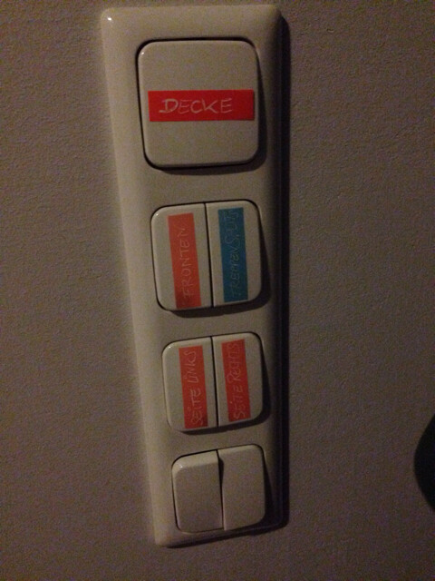

He installed everything exactly as I wanted, so we have no dusk sensor control on the front of our house.
Our two up-down lights in the gable are controlled by one switch. The same applies to two lights on the left side of the house and two lights on the right side. So: 3 switches for 6 lights.

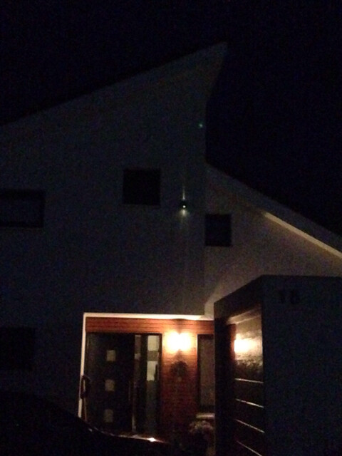

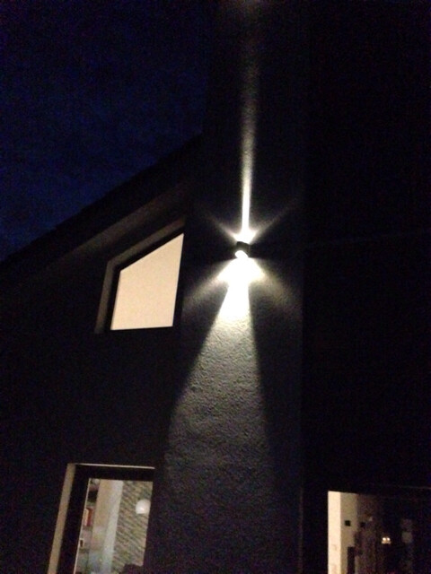

Unfortunately, the lamps are only equipped with LED boards. When they fail, the entire lamp has to be replaced. This is the biggest downside the industry has come up with. I’m only noticing it now. And yes: they are not an option because of the lighting.
At the moment, we have the Canto from Nordlux.
Garden side
Entrance side (which is now about to give out)

However, in our setup the switches share a single slot.
So we would need to have the circuits swapped.
For that, we need an electrician. Then we could also integrate a rectangular sensor “into the circuit,” which would likely comply properly with regulations and work satisfactorily.

toxicmolotof30 Jul 2016 23:20If all three switches are located together in one place, you can connect them and install a timer with an astro function in between.
It probably doesn’t get any simpler than that.
