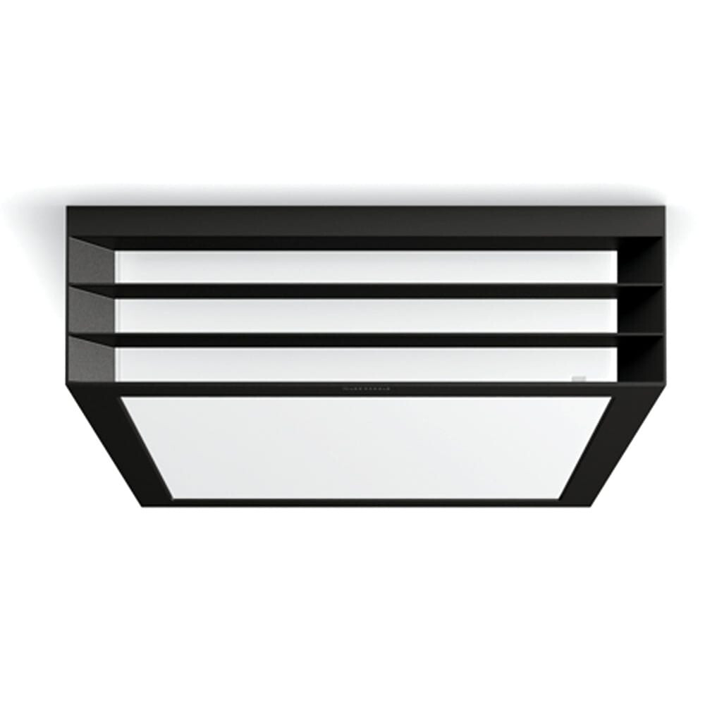

Another solution, and probably the simplest, would be to get a suitable lamp without integrated LEDs and then add LED bulbs from, for example, Philips Hue. You can then control them via an app to turn on and off. The advantage is that you don’t have to fiddle with the electrical wiring and don’t need a professional for that.
I’ve attached one I found that would work. It should be bright enough because it has two sockets. If it’s too bright, you can easily dim it.

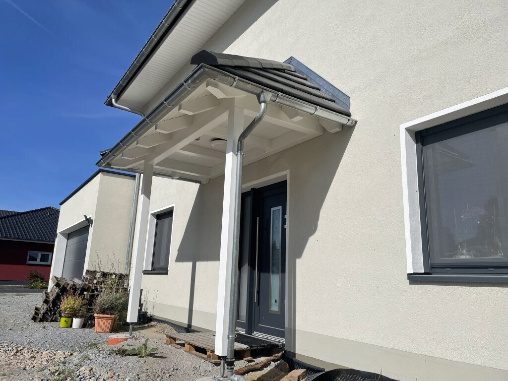

In our case, it looks roughly like this:
Modern house facade with canopy, dark door with glass strip, window, and gravel ground.
As I can see in this picture, there is also a ceiling light installed here 😀
We would really like something similar, of course for a reasonable price and with a nice design (rectangular and in anthracite).
I had also considered the Philips Hue option – unfortunately, this only allows control by TIME and not by motion... 🙁
Either we have to invest quite a bit and buy a fixture for 150€ (I already found one like that) or look for other solutions...
danixf
22 Mar 2022 13:37
We would love to have something like that as well, of course for a reasonable price and with an attractive design (square and in anthracite).
There is also a motion sensor at the front. If it’s still possible to run a second cable somewhere, you could use a motion sensor. However, in my opinion, it looks a bit questionable...

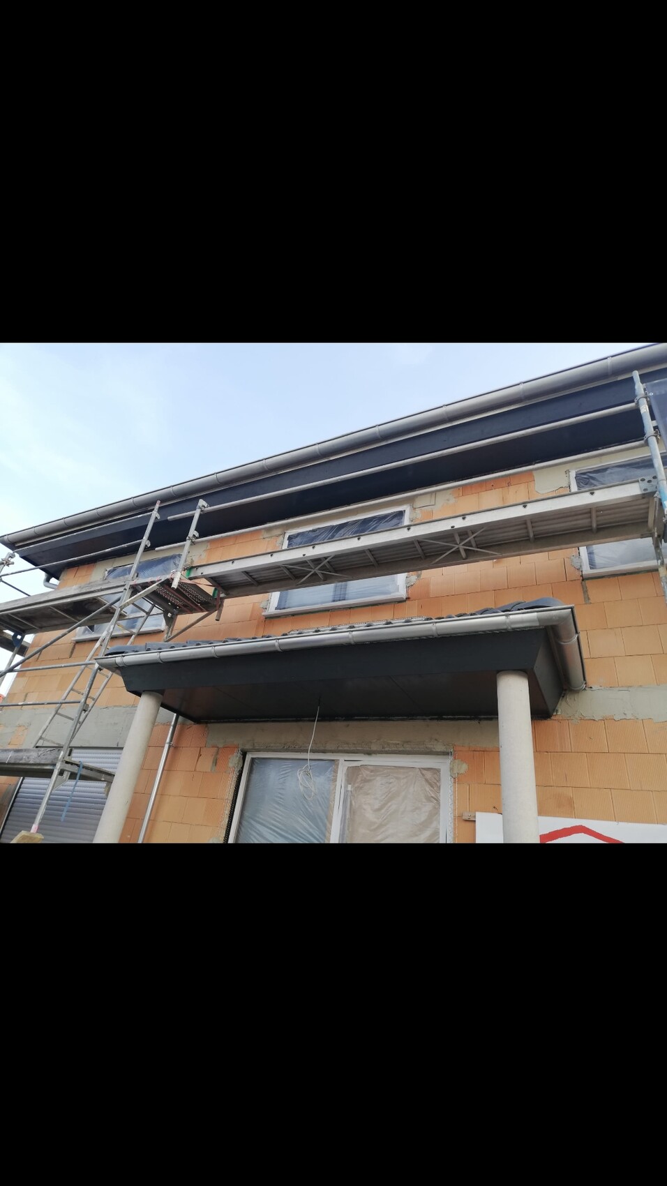

Why do people usually show pictures from somewhere else instead of their own construction site or house?
The light fixture is basically “shielded” there, so integrated motion sensors don’t work very well.
I would have planned small LED spots from the start…
Prager91
22 Mar 2022 13:47
driver55 schrieb:
Why do people usually show pictures from elsewhere instead of their own construction site or house?
The lamp there is basically “shielded,” so integrated motion sensors don’t work well.
I would have planned small LED spotlights right from the start…
Here is a picture of our entrance.
