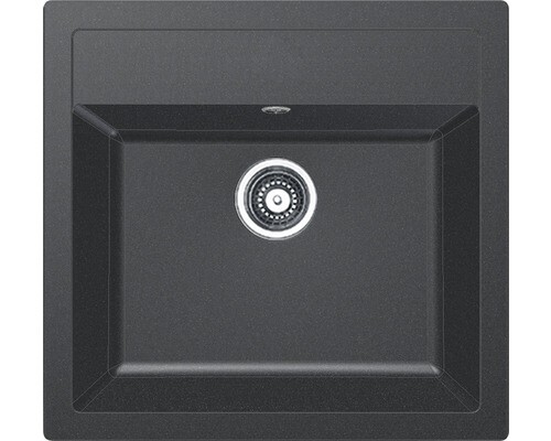

My wife really wants this sink:
It was basically love at first sight.
Now our question is: Can I connect the Atlant siphon, single bowl, item number: 202.155.23 to this sink? We’d like to install a small drawer underneath the sink.
