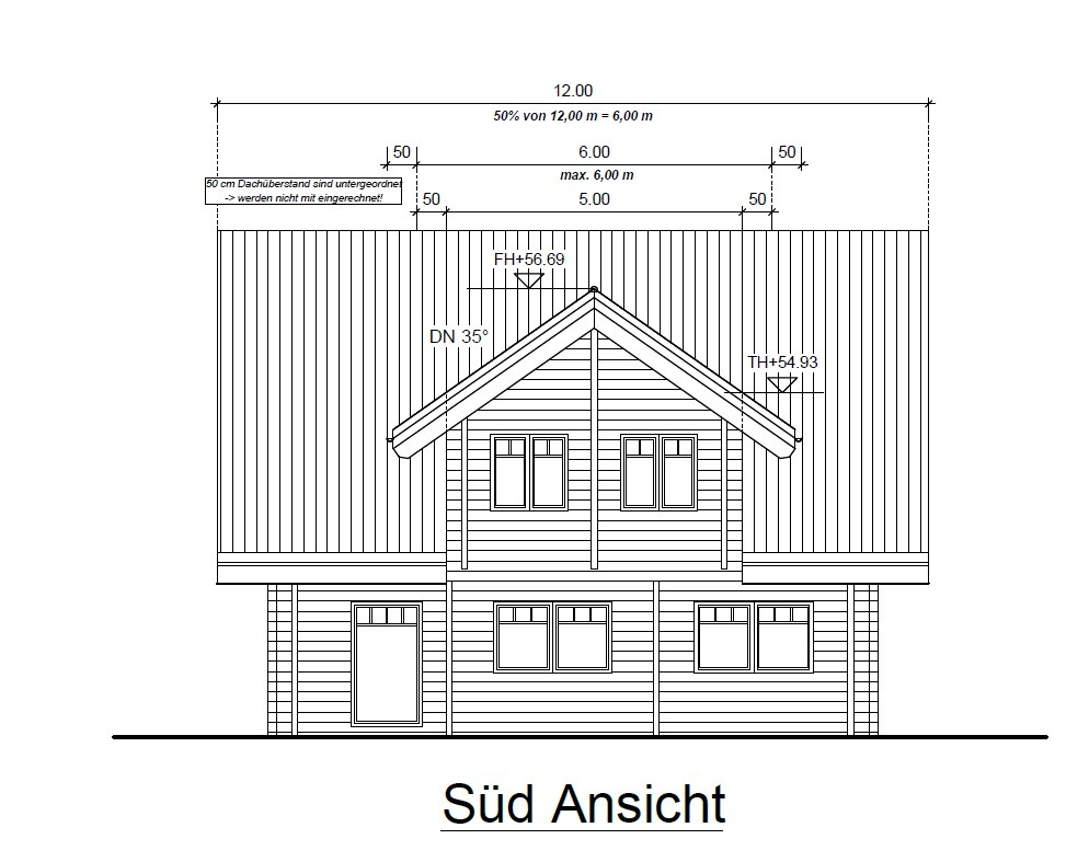

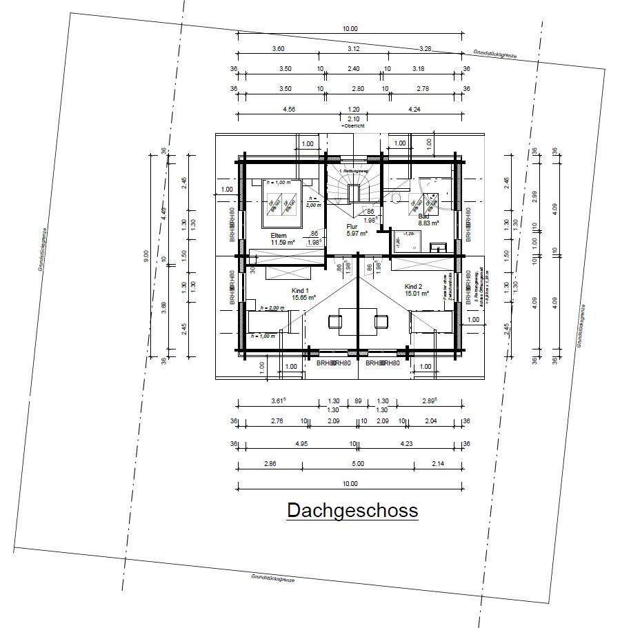

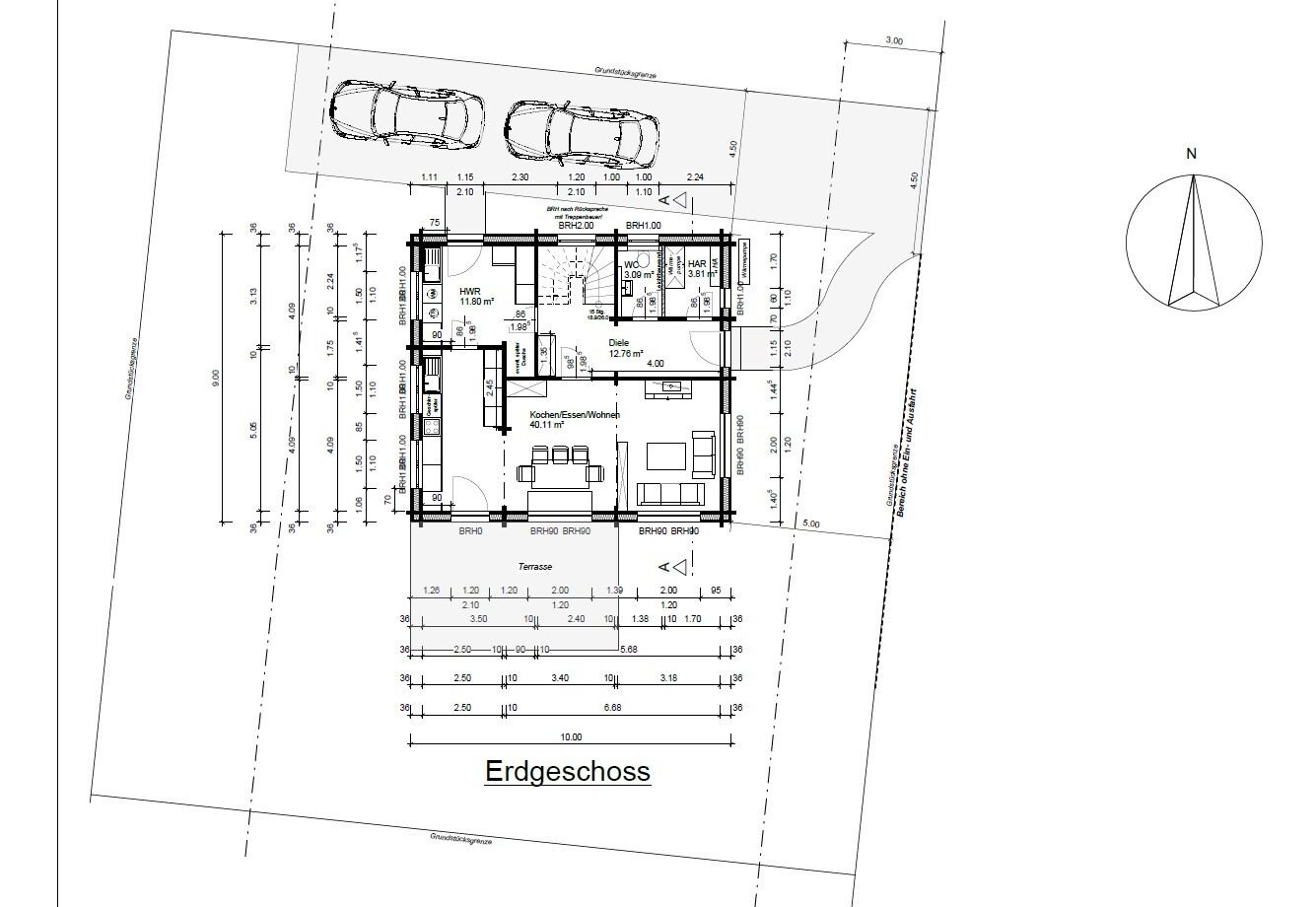

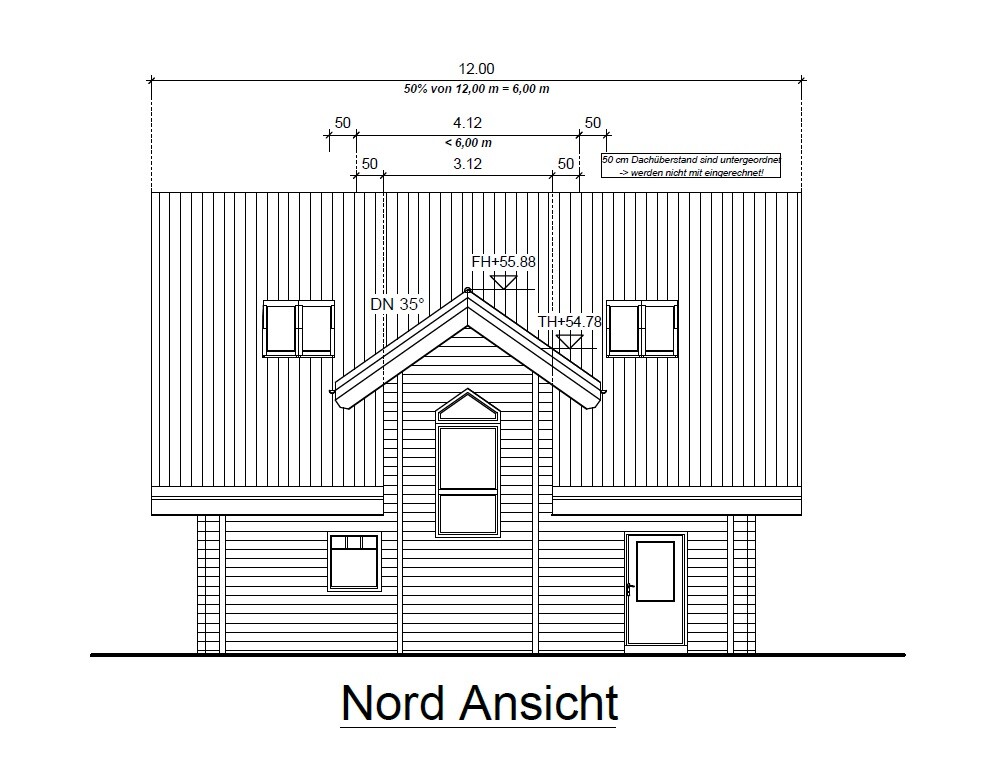

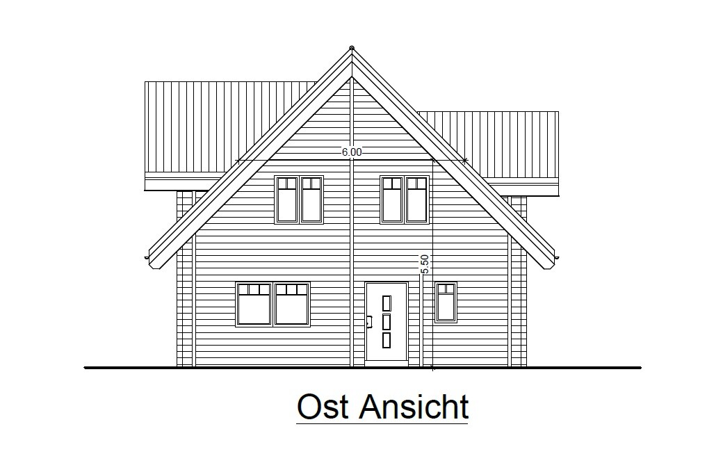

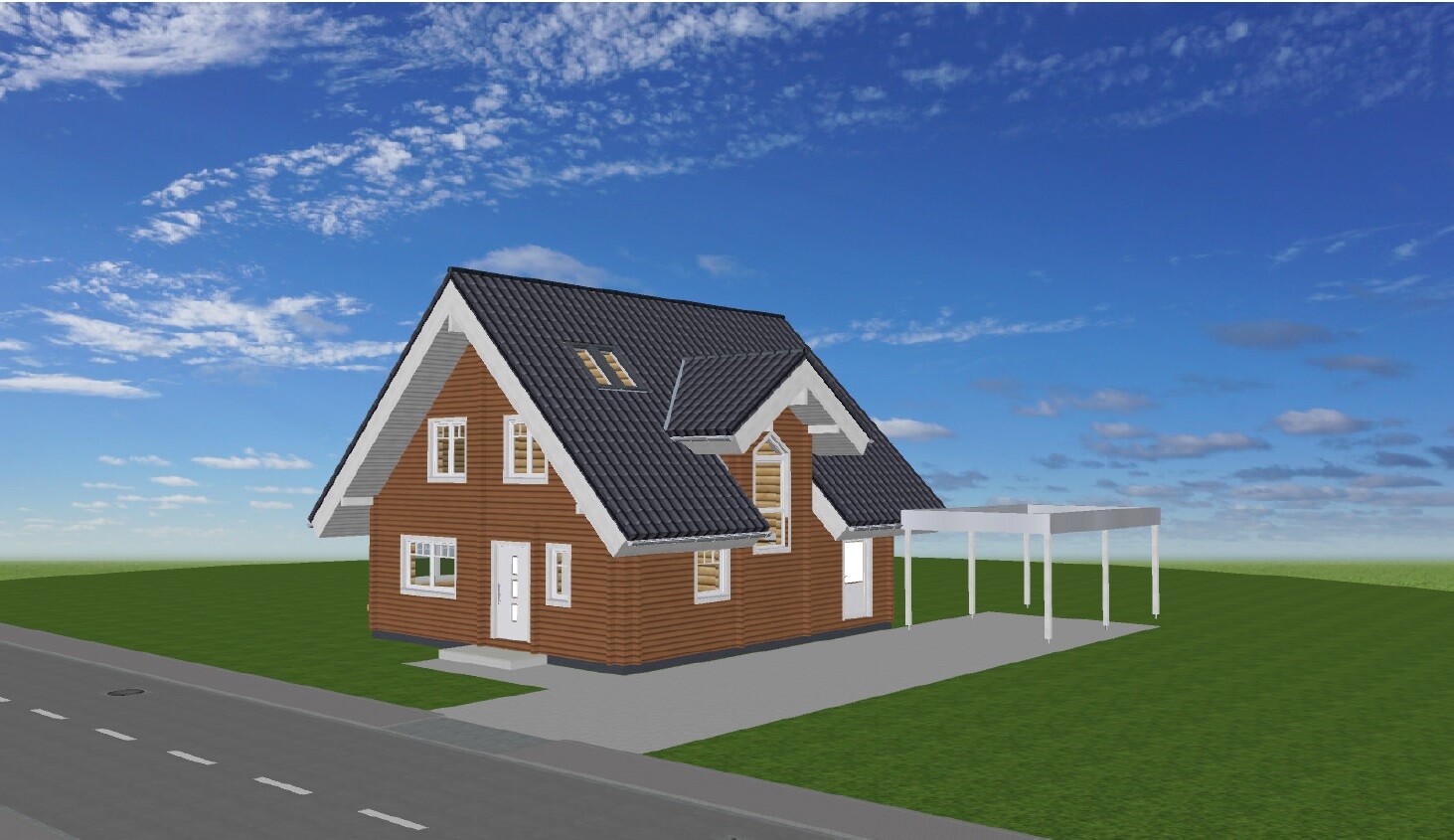

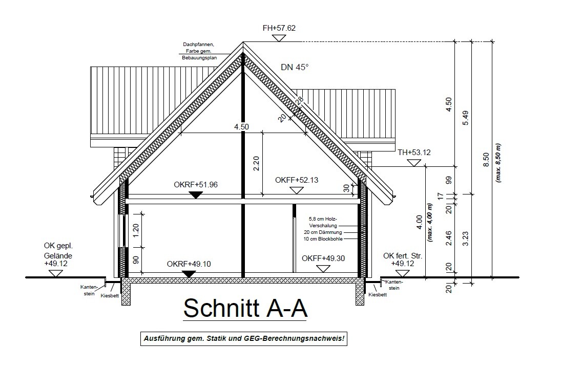

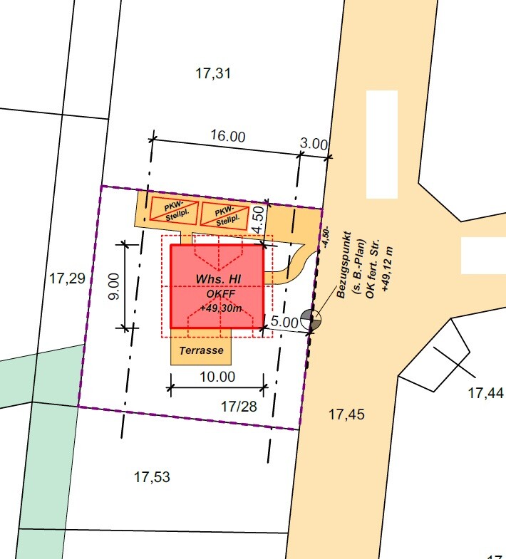

Thanks to your abundant feedback, you luckily prevented us from building a dark dwarf cave, and we completely restarted the floor plan from scratch. Now we have finally reached the point where our building start notification is with the building authority *cheers* So now it’s a four-week wait, and then construction could begin.
Below are the final floor plans, elevations, and sections. Also included is the site plan showing our house on our plot. Here is the link to our floor plan thread: https://www.hausbau-forum.de/threads/grundrissplanung-efh-massivholzbauweise-140qm-in-niedersachsen.44745/
If there is interest, I could create a small "construction diary" here from this thread… Since we are not building turnkey with a general contractor, there will surely be some avoidable mishaps, but that somehow also belongs to the experience… 😀 We would definitely appreciate feedback and will likely have some questions during the build where we will need your assistance… 🙂

We (m37, f30, and little m6) dream of a cozy home and were fortunate to get a plot in a new residential area in a neighboring village through the city in May 2022. The brutal price surge and material shortages almost made us give up, but in November we re-evaluated what we really want. The budget is limited, the times unpredictable, and interest rates naturally much higher than we would like… But ultimately, the decision was clear: with a lot of own effort, we still want to give it a try. Now or never, and if so, it should be a place with a feel-good factor. Those who have read our floor plan thread know: we are building a timber house. Wall construction: inside 10.0 x 21.8 cm (4 x 8.6 inches) spruce planks – 20.0 cm (8 inches) blown-in cellulose insulation – 5.8 cm (2.3 inches) spruce paneling as exterior cladding = KfW40 standard, which was important to us. The house has a continuous one-meter (3.3 feet) roof overhang. Roof insulation, visible roof structure, and *unfortunately* only a permitted eaves height of 4.00 meters (13.1 feet) according to the development plan, which was a major challenge for us as first-time builders… 🙁 But we believe we have now found a solution so that our upper floor will still be reasonably usable despite the only 30 cm (12 inches) knee wall, thanks to the south dormer for the children's rooms and the north side for the staircase.

We have a roof pitch of 7 degrees because the development plan limits the maximum height of shed roofs to 7 m (23 ft). Gable roofs are allowed up to 9.5 m (31 ft) high. The roof covering will also be trapezoidal metal sheets.

We have a 7-degree roof pitch because the development plan allows a maximum height of 7m (23 feet) for shed roofs. [...] The roof covering will also be trapezoidal metal sheets.A log house with a shed roof covered in trapezoidal metal sheets—that honestly sounds a bit like apricot dumplings with horseradish ;-)https://www.instagram.com/11antgmxde/
