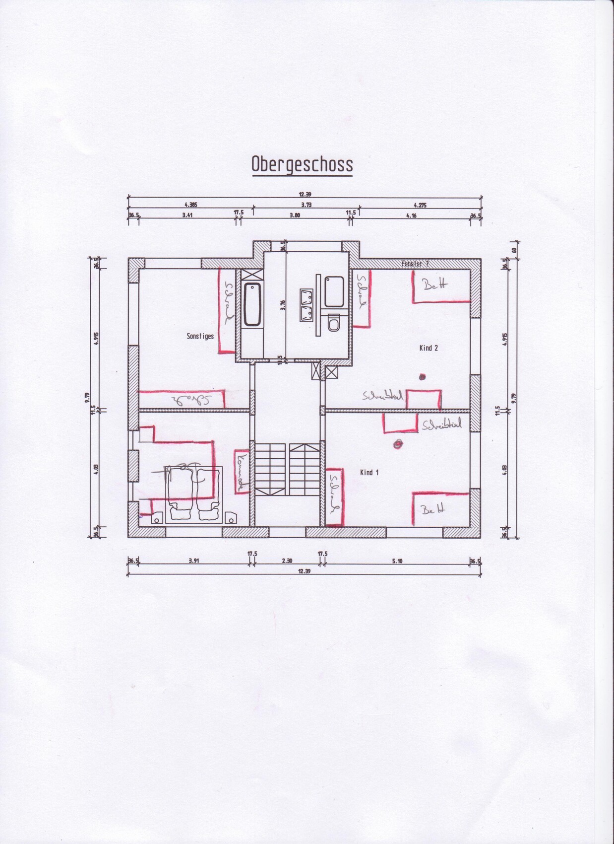

Since we will probably be purchasing our plot soon, we are currently in the planning phase and have created the attached floor plan together with our designer.
All our wishes have been taken into account.
The elevations are the first draft; we are working on them diligently and hope to get some input here through suggestions and criticism.

First of all, thank you for creating the images.
And congratulations as well, since I know it wasn’t entirely easy for you. 🙂
Without the garage, I count only 7 corners; ours has 6... Sure, a simple box shape with four corners, straight walls, and a roof is the cheapest but also the most boring design. I don’t like bay windows, but meaningful projections... Well,
I also notice some smaller details with the window placement?
Where will the wardrobe go (did I miss something)?
P.S. In the laundry room (what a word...) I would prefer natural daylight and a real window.
Creating the images wasn’t that difficult after all...
I quickly furnished the upper floor for you. We have already revised the window positions and will discuss them with the planner.
kbt09 schrieb:
Hmm, the floor-to-ceiling windows in the bedroom on the upper floor don’t really fit with the furniture layout, not even in their current positions.
Also, it would be great if you could crop the images to show only the important parts before saving them with the white border 😉We plan to install a clerestory window above the bed. We’re still unsure how to design the other window. We are really pondering over this...
kbt09 schrieb:
Really a strip window? Difficult to clean and not really significant for the amount of light. I would probably leave out the window. From the outside, it always looks a bit like an arrow slit. You still have a window on the other wall. The strip window should be operable.
And the window on the other wall faces the neighbor.
I would swap the rooms, slightly shift the central wall, and add a window with a standard sill height at the top of the plan.
The four vertical window bands on the left side of the plan should be aligned vertically, and the bathroom mirrored accordingly.
I would omit the light strips above the virtual beds.
