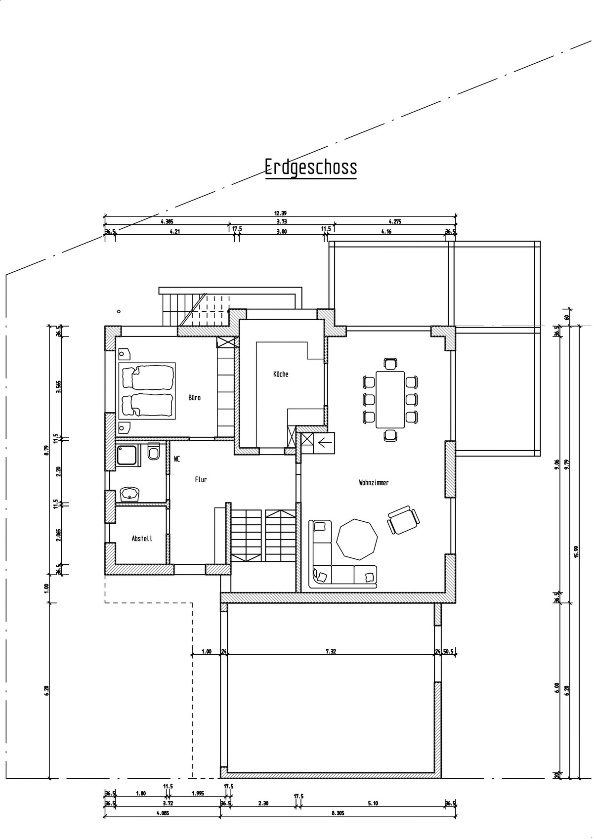

Since we will probably be purchasing our plot soon, we are currently in the planning phase and have created the attached floor plan together with our designer.
All our wishes have been taken into account.

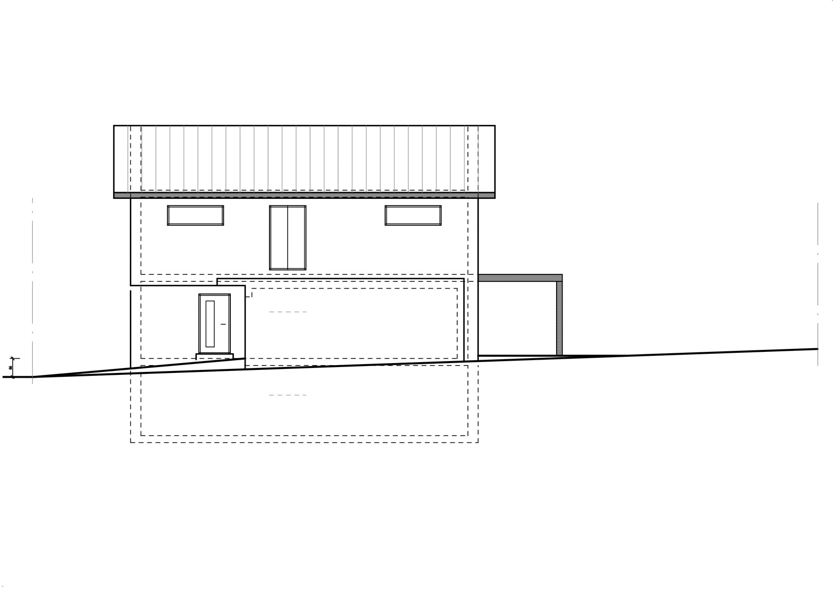

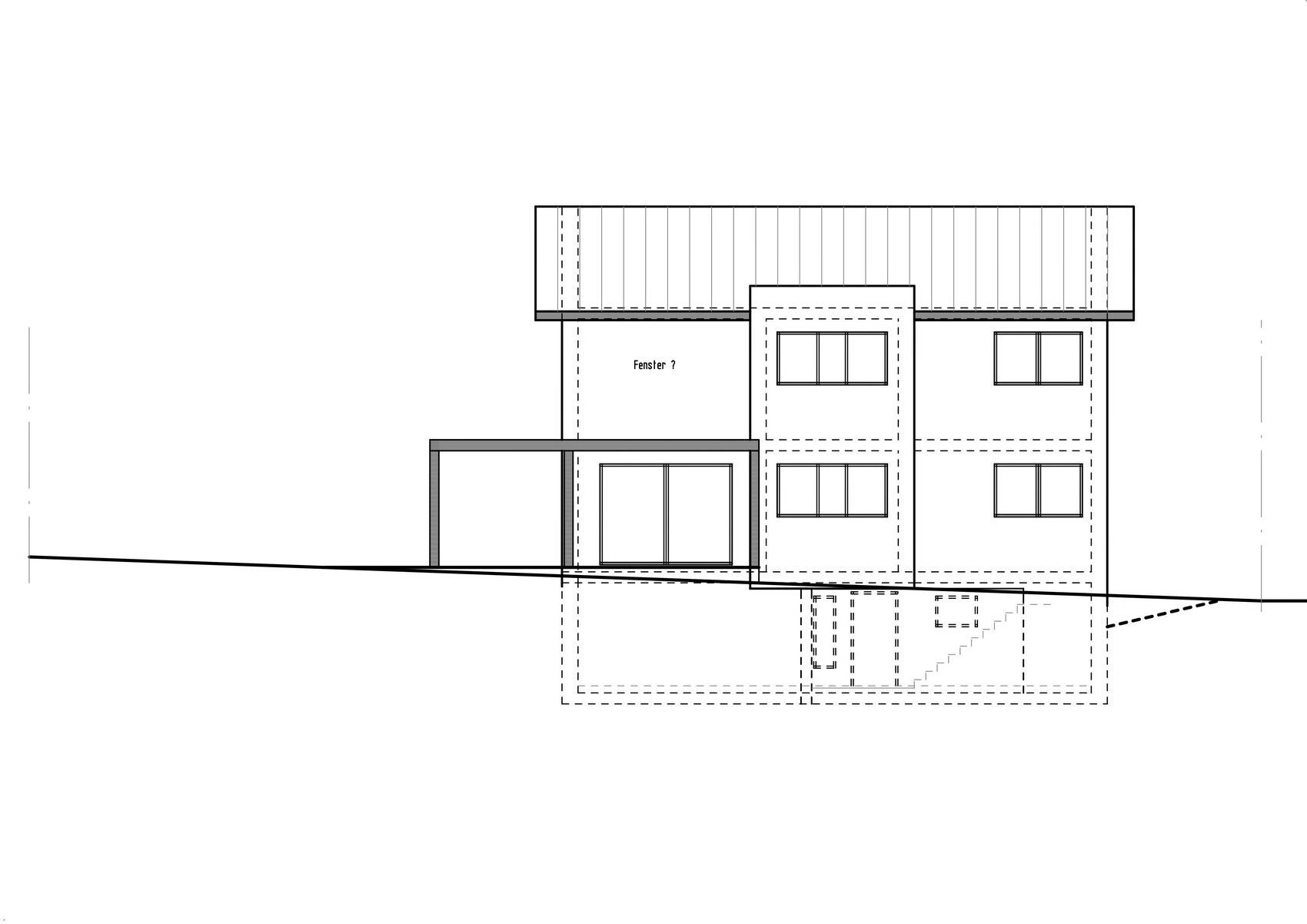

The elevations are the first draft; we are working on them diligently and hope to get some input here through suggestions and criticism.

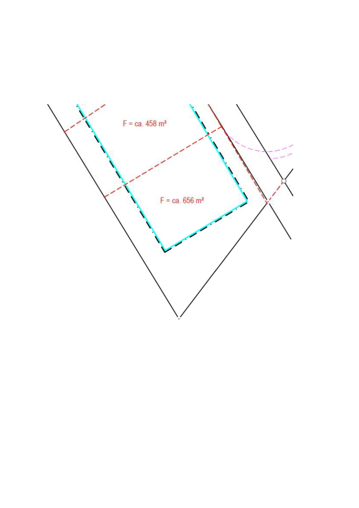

Plot size: 656 sqm (7,060 sq ft)
Slope: minimal gradient from south to east
Site coverage ratio: 0.3
Floor area ratio: -
Building window, building line and boundary: 16 m by 20 m (52 ft by 66 ft)
Edge development: corner plot (at least currently, and we hope it stays that way)

As mentioned at the beginning, we are still working on the elevations and are open to all criticism and suggestions, especially regarding window sizes. For example, we do not want floor-to-ceiling windows on the upper floor.

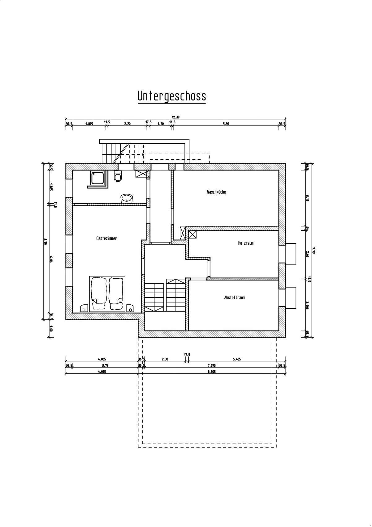

@Nofret: We debated the location of the laundry room for a long time. In the end, we settled on this spot because my wife likes to dry laundry outdoors and therefore prefers the short route here.
@Jochen104:
@all: Would you swap the storage room with the laundry room in the basement? The idea was to have a small daylight window in the laundry room. Or do you think a light well would be enough?
One more question: Would you align the office wall with the kitchen wall on the ground floor?
@Jochen104:
- The style direction referred to the exterior views. From my perspective, there aren’t many corners.
- The doors fit, I just spoke with the planner again.
- The shower is planned in case the office is used as a bedroom in old age. We’re now unsure whether we even want this shower since the guest toilet isn’t very large.
- The TV will go where the couch is currently placed. The couch will be moved to the exterior wall, so there won’t be a floor-to-ceiling window here. Why do you ask?
- The second door to the guest room will probably be removed. I also find the narrowing of the corridor here unfortunate, but that’s because a service shaft runs down through the bathroom in the basement, making the corridor narrower here. Maybe we will adjust the wall so the corridor is continuous.

I looked at the floor plans: I would straighten the hallway on the ground floor by slightly enlarging the office, and swap the shower with the toilet upstairs (for light and privacy reasons).We will straighten the hallway; then the corner will be in the office, and the hallway will appear more harmonious.
Really swap the toilet?

If that odd intermediate door including the attached wall is removed, it probably doesn’t matter much. One time you have a longer route for laundry, another time for pantry access 🙂 We will discuss this again with the planner. Thanks already for your tips.
First of all, thank you for creating the images.
Secondly, congratulations, as I know it wasn’t entirely easy for you 🙂
Counting without the garage, I see only 7 corners; ours has 6… Of course, a simple design with 4 corners, straight walls, and a roof is the cheapest but also the most boring option. I don’t like bay windows, but practical recesses are fine... Well,
I also notice some smaller issues with the window positions?
Where is the wardrobe planned (did I miss something?)
P.S. In the laundry room (what a word…), I would prefer natural daylight and a proper window.
