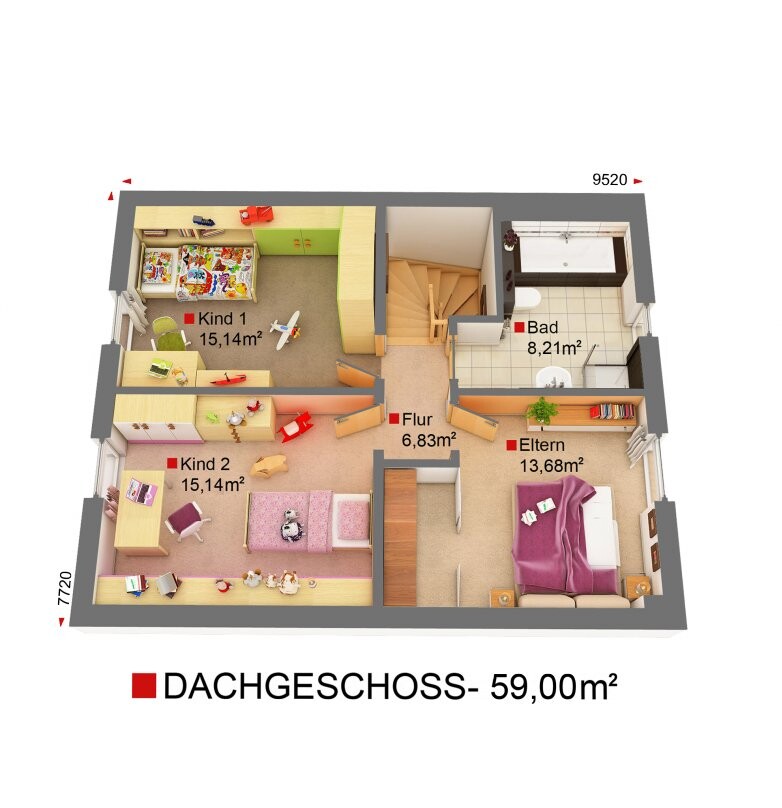

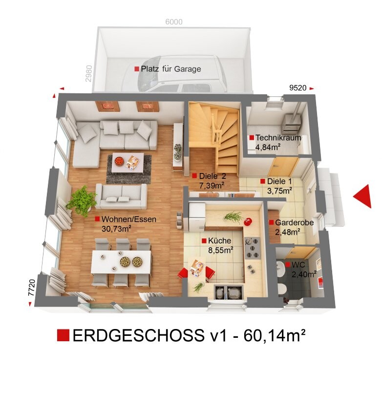

We have now found the floor plans that suit us and will review them with our architect on Monday. They basically include everything we want. Maybe you have a few comments on them as well.
Attic plan: corridor, master bedroom, two children’s rooms, bathroom; 59.00 m² (635 sq ft).
Ground floor: open living/dining area, kitchen, hallway, stairs, cloakroom, WC, utility room
24 Oct 2013 22:17
What is your architect’s role? Is it just to approve your floor plan, wherever you got it from? Are they only supposed to create the drawings, period? Or do you have an architect for free, at no cost, complimentary?
