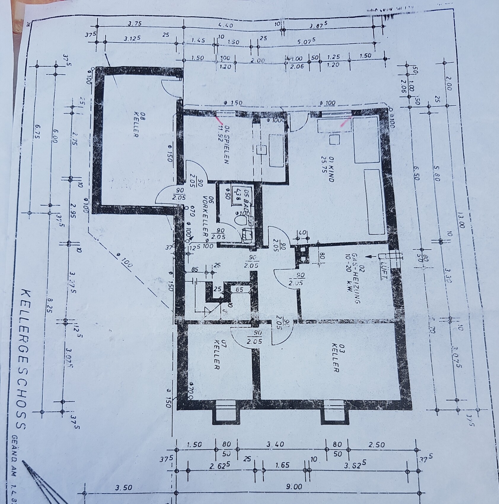

We want to separate the basement as a granny flat (secondary dwelling), also considering the possibility of renting it out in the future.
Now to the basic problems and questions.
My father insists on having one boiler/heating unit per dwelling. To better calculate the consumption.

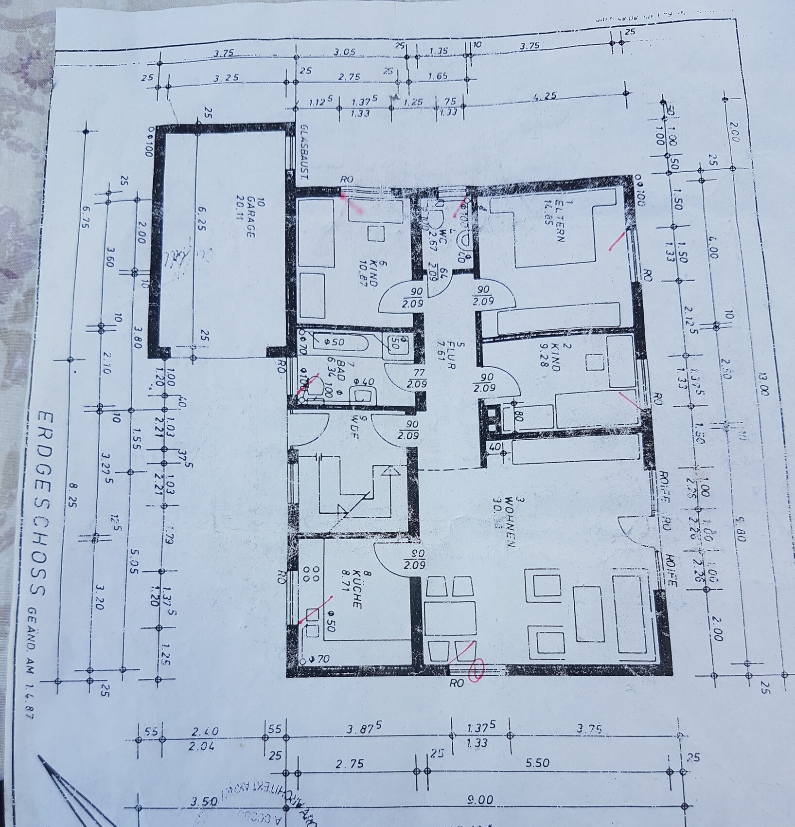

On the ground floor, walls will also be removed. Rooms 2Child and 3Living will be combined; rooms 7Bathroom and 5Child will form the new bathroom. Room 4WC will be removed completely.
How exactly would one integrate a boiler in this configuration if my assumption above is correct? Am I right in thinking that these boilers are those tank-type units hung in bathrooms/kitchens, like in caravans or older apartments? That would be a complete deal-breaker for me.
Is it possible to run an exhaust duct several meters through the apartment up to the chimney? Or do you have other ideas? Please feel free to get creative!
