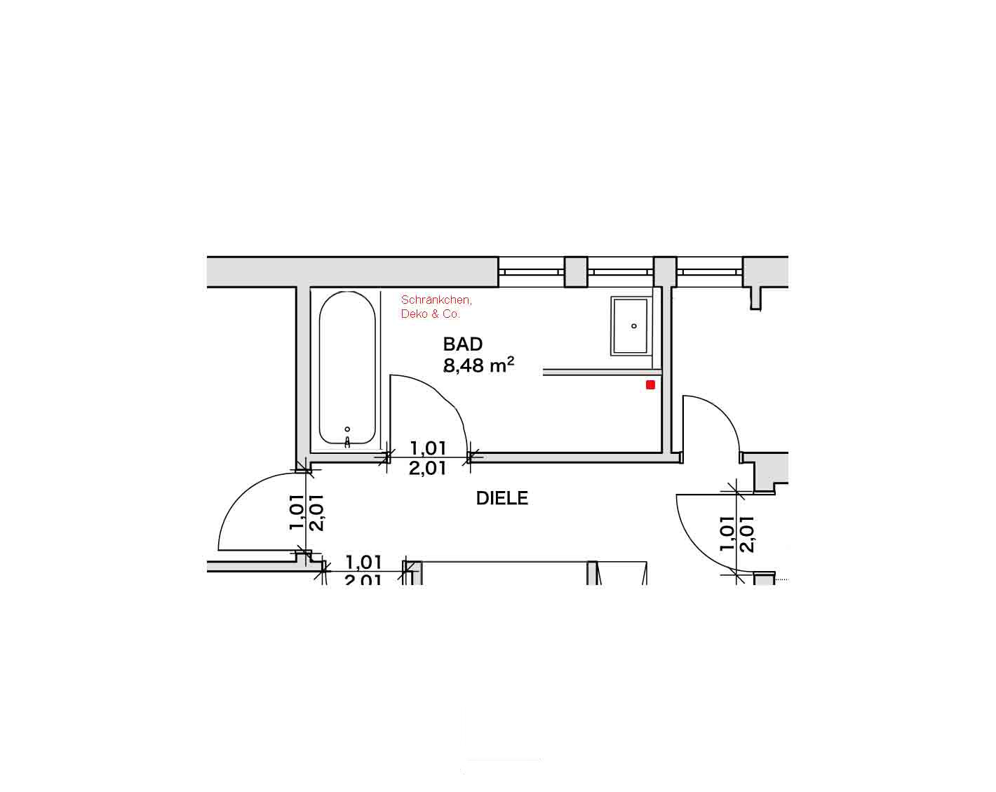

We initially decided to put the bathroom planning on hold since there were plenty of other issues to address. However, as the detailed planning is currently underway and we are also looking at the electrical installation, we took a closer look at our bathroom and aren’t really satisfied. Of course, the bathroom is quite small, so there aren’t many options, but there is definitely room for improvement.
Generally, it’s bothersome that there is little space around the bathtub (for decoration, toiletries, and our daughter’s toys), and that the toilet somehow ends up as the focal point of the bathroom. We also prefer not to have the sink and toilet right next to each other. My wife would like to have compartments for towels integrated into the partition wall, which means we need enough space for that.
Attached are the current plans and our thoughts from today.
PS: The bathroom windows are small, 80 x 80 cm (31.5 x 31.5 inches), and the window sill height should be around 150 cm (59 inches).

What bothers me about the plan is that you basically have the door right behind you when standing at the washbasin. But from your responses, I can tell that you’re not really looking for suggestions, but rather confirmation. Personally, a bathroom like that in a new build would be way too small for me, but as they say, everyone’s will is their own heaven...
Even though I think the advice might be wasted: have you considered placing the washbasin next to the shower? That way, the person entering the bathroom won’t run into the back of the person brushing their teeth (especially since children can be quite energetic).

This is the first time I’ve heard that. We would be more bothered if you were looking straight at the toilet. No relaxing potty time here. I agree the bathroom is small and compactly designed. You just have to be modest in a new home. 😉

Why not simply place the toilet next to the shower and the sink opposite it? This way, when you enter the room, you don’t have to look directly at the toilet, and you come out of the entrance area more comfortably.

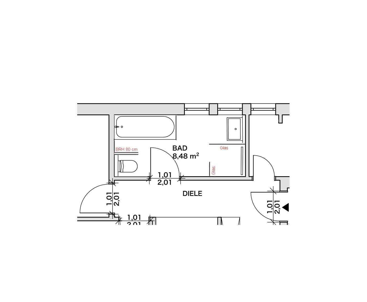

I would generally lean towards the second design option; it feels well constructed and at first glance looks open and inviting, despite the relatively small bathroom. However, in my opinion, the placement of the washbasin is poorly chosen in both layouts – the light hits the sink from the side, but I think it’s insufficient; *I* wouldn’t be comfortable with side lighting, if it’s from the side then it should be consistent.
Have a look at the attachment – *I* would probably forgo the toilet in the bathroom, since there is one conveniently located close by. If a toilet is to be included in the bathroom, then the lighting should, in my view, be “artificially” extended. For example, with glass panels in the shower area.
