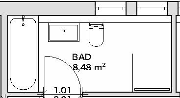

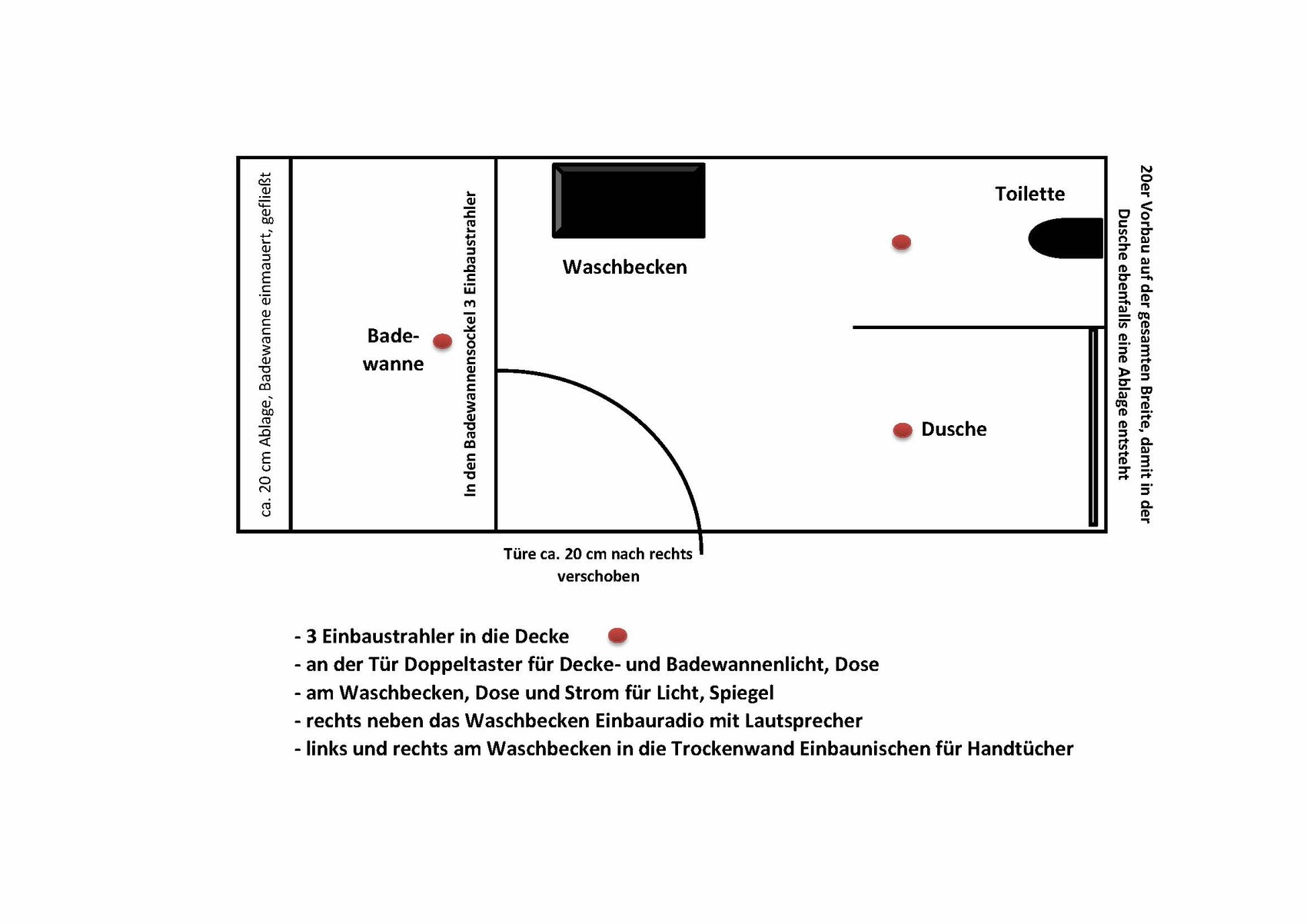

We initially decided to put the bathroom planning on hold since there were plenty of other issues to address. However, as the detailed planning is currently underway and we are also looking at the electrical installation, we took a closer look at our bathroom and aren’t really satisfied. Of course, the bathroom is quite small, so there aren’t many options, but there is definitely room for improvement.
Generally, it’s bothersome that there is little space around the bathtub (for decoration, toiletries, and our daughter’s toys), and that the toilet somehow ends up as the focal point of the bathroom. We also prefer not to have the sink and toilet right next to each other. My wife would like to have compartments for towels integrated into the partition wall, which means we need enough space for that.
Attached are the current plans and our thoughts from today.
PS: The bathroom windows are small, 80 x 80 cm (31.5 x 31.5 inches), and the window sill height should be around 150 cm (59 inches).
2D-Badezimmer-Grundriss mit Badewanne, Waschbecken und Toilette sowie Tueröffnung.
Grundriss eines Badezimmers mit Badewanne, Waschbecken, Dusche und Toilette
Neige11 Jun 2016 20:13
Please provide the full dimensions of the entire structure.
MarcWen11 Jun 2016 20:51
What should I measure in detail? The bathroom is about 2 meters by 4 meters (6.6 feet by 13.1 feet).

And this is basically what it’s about...
12 Jun 2016 00:15
I would swap the bathtub and shower.
MarcWen12 Jun 2016 11:57
matte1987 schrieb:
And this is roughly what it’s about...
Dimensions according to the plan: 2 x 4.24 meters (7 x 14 feet)
Without plaster, tiles, and possibly drywall.
In our revised plan?
We had originally considered that too, but it would make the movement paths more difficult with a commode chair.
As it is currently planned, you could move straight from the door into the shower.
