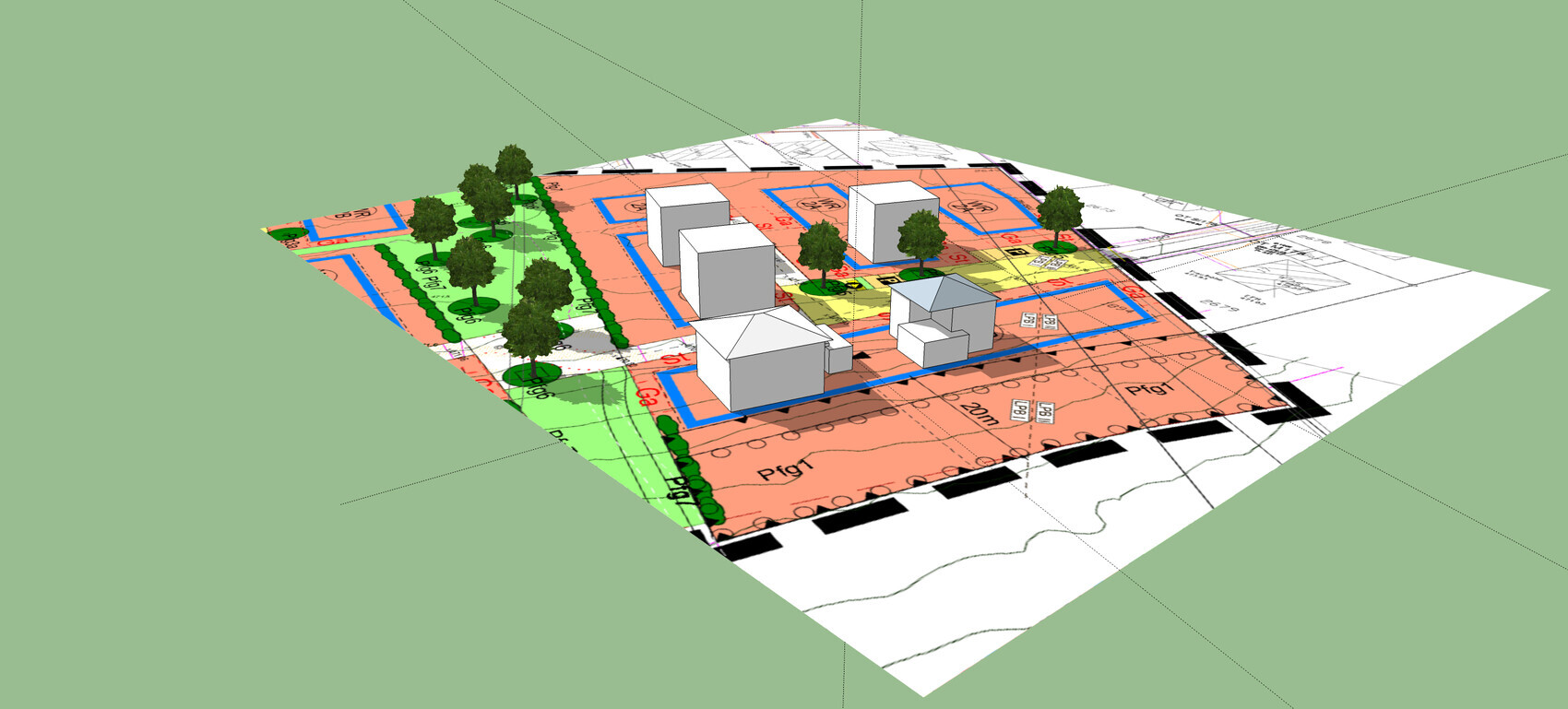

Since the plan of the neighboring plot to the south is available, I took the time to get familiar with Google Sketchup.
Image: Shadows on 21.05. at 4:30 pm

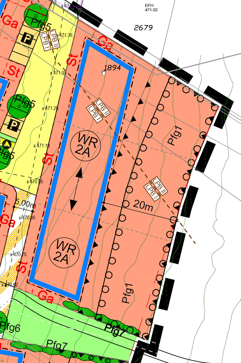

Our plot is the middle one of the three, measuring 22.5 m x 38.5 m (a contour line corresponds to 0.5 m (1.6 ft), so it is only a slight slope, which, as you can see from other buildings along the street, can be easily leveled.
Since the plot is relatively narrow at 22.5 m (74 ft) and I don’t want my south-facing terrace to be right next to the neighbor, I’m now considering how to position my buildings to move as far north as possible.
Garages and carports must fit within the 15 m (49 ft) wide building zone. A double garage would push me too far to the south...
What to do?
What to do?
The house shown on our property was just a rough draft. We are still completely open and undecided regarding the house and roof design :-)
The north-south orientation is correctly set in the images.
I will also obtain the plans for the two additional neighboring houses to the west and model them accordingly.
